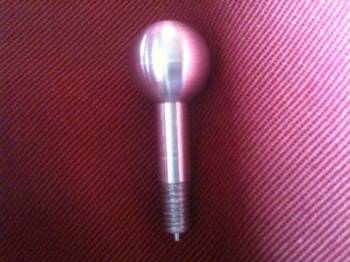

I managed to cut a ballhandle which came out ok'ish for a first effert apart from the screwcutting operation the post processor out put G33 X Z I K and the cutoff opp ;-) Picture attached.
