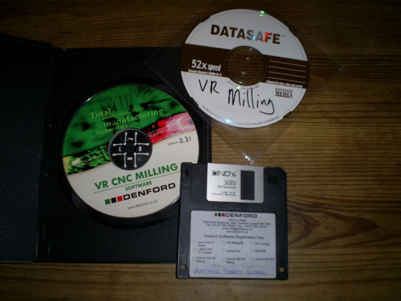

I have acquired a StarMill ATC, it came with the Control box, Desk Top Tutor and VR CNC Milling software Version 2.31.

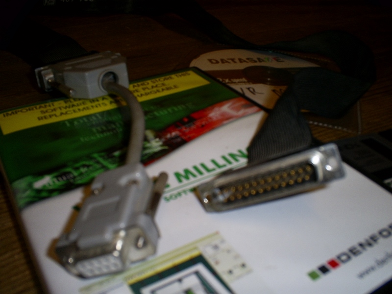

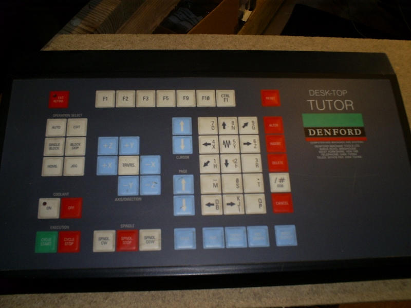

If you are running VRMilling version 2.31 you do not need the desk top tutor as you control it directly from the computer. Therefore you will only need 1 Com port.
Make sure you use the correct RS232 lead as the two in the second picture are not.

Martin wrote:If you are running VRMilling version 2.31 you do not need the desk top tutor as you control it directly from the computer. Therefore you will only need 1 Com port.
Thanks for taking the time to respond chaps.
I am not overly bothered about using VR Milling software, I am hoping just to use G Code programming. Am I right in assuming that the desk top tutor is there for this purpose?
Also, the 2nd picture is both ends of the same lead which came with the machine. Again I assumed (because of the length and fitting arrangement) this to be the cable between a PC and the desk top tutor.
If I am correct (please advise) then will I need to purchase another ribbon type RS232 cable to connect the control box to the port of the PC? Where would I buy one of these please? A part number would be good to make sure I get the right one.
I may take you up on your offer Pete I am in Kings Lynn. As you say we can come to some arrangement, but I need to get everything here first Compressor, another cable and a PC. As I said above I would want to program in G Code so your PC may not be suitable, right?
Lastly, the emergency stop is in and I do not have the key, guess I will need to purchase another.
Re: Recommended PC for StarMill ATC
Post by Martin » Thu 11 Dec , 2014 15:05 pm
VRMilling does use G & M codes. I presume it has been upgraded at some point to VRMilling which means the Tutor is obsolute.
The cable you have is a pin to pin & not a RS232 lead.

I wonder if the 25w to 9w has the required mods inside linking just the required pins to make it RS232.
The flat cable is just the same as the one that was attached to a desktop tutor a friend bought with a starmill from the same school I got my starturn from. His was also upgraded but to a USB control board so the tutor keyboard he has is also redundant.

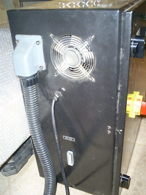

Do you have access to a multimeter? just thinking you should test the RS232 leads to find out what pins are wired to what.

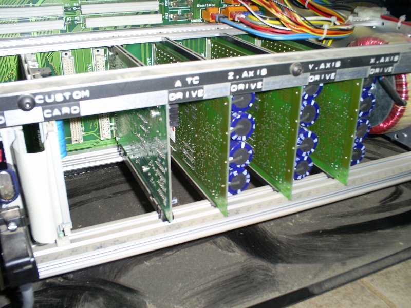

Also have a look on the inside of the black box to see what pins on the 25way are connected. I have a genuine Denford black Lindy 9pin to 25pin RS232 lead on my Starturn and had to swap the TX and RX lines over in the black box to get it to work. Probably why the school couldn't get it working years down the line.

Up and running!! many many thanks to TDIPower and Traic.
It was down to swapping the TX and RX pin connections over on the cable which came with the machine as Pete said above.
