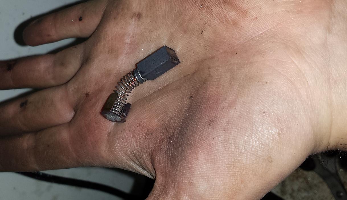

After finally managing to remove the motor, I pulled the brushes out to inspect them.
To be honest, I'm not really sure what a good brush or a worn one should look like.
Does anyone have any idea whether or not these brushes look any good or not?

Post by angel-tech » Fri 15 Nov , 2013 0:48 am
they don't look too bad, were they sticky to get out or did they slide out easily?

They look like new. I presume the spindle is free to turn by hand?
I don't think I have elver come across a faulty motor before on a Starmil. Are you able to check the output from the spindle drive? You should have around 120 volts DC when asked to run at top speed.

Thanks both. Although I don't have a lot of experience to go on, I thought they looked OK too.
They certainly came out pretty easily and yes, the spindle turns by hand. I replaced the bearings in it earlier in the year so I know they're good too.

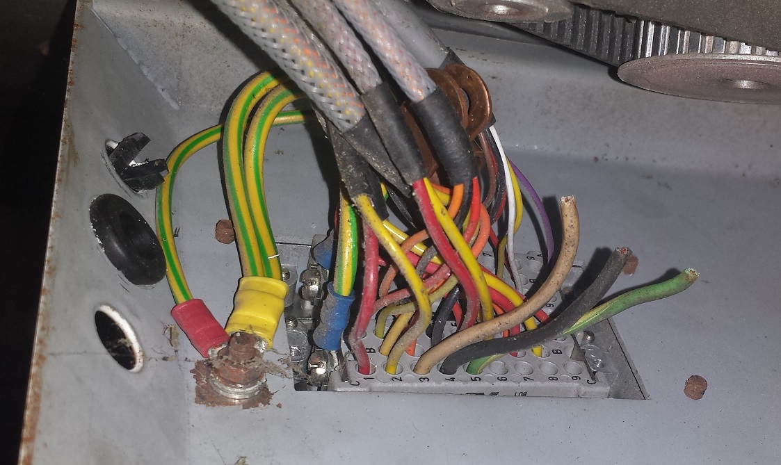

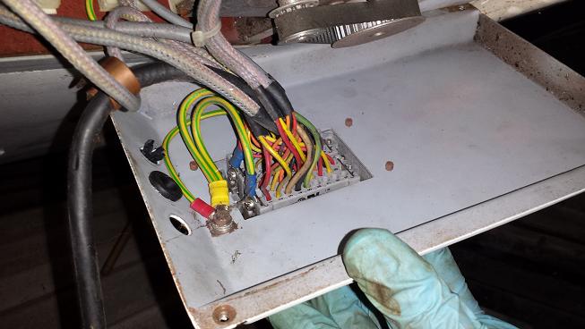

One question though, the attached picture shows the wiring into the connector block on the back of the machine.
Does anyone know if it's possible to remove the wires from the connector block or will I simply have to cut them?
Many thanks

Post by Martin » Tue 28 Jan , 2014 23:29 pm
You need a pin extractor to remove from the barring plug.

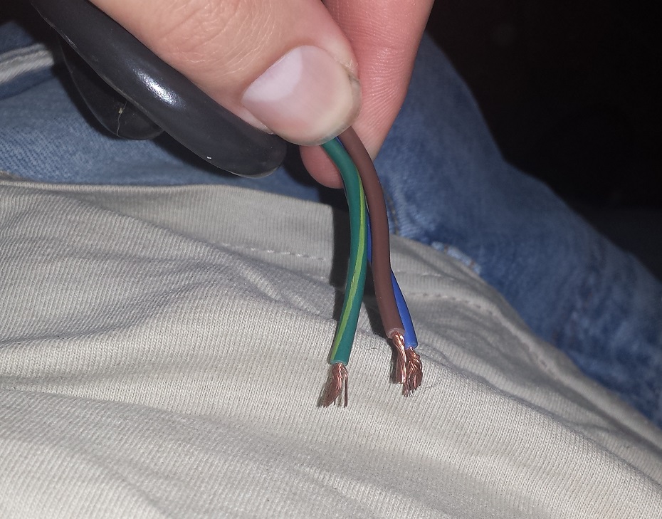

The wires on the new motor are:
Brown
Blue
Green/Yellow
Am I right in thinking that the new wires should go:
Pin3 - Brown?
Pin4 - Blue?
Pin5 - Green/Yellow?
Thanks!
