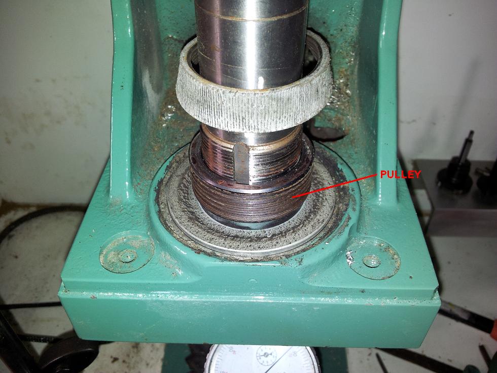

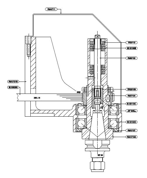

I also removed that nut to have a look at the pulley. From looking at the attached assembly drawing (from this forum) and the picture I've attached showing the pulley (minus tab washer and retaining nut), it seems to me that the nut and tab washer are there to stop the pulley unwinding itself. It also looks like the pulley sits straight onto the top of the two bearings, so really it would be the pulley I would be wanting to tighten rather than the retaining nut?
Whether tightening solves the problem or whether I end up having to replace the bearings, I'm still going to have to tighten/loosen this pulley in one way or another and I can't see any obvious way of doing so! It has two recesses on the internal thread (like the channels you would expect to see for a woodruff key), I'm wondering if there is some sort of special tool that maybe locates into these enabling you to tighten/loosen the pulley?
Thanks again!
Re: Possible Spindle Bearing Replacement
the pulley isn't threaded in that diagram, so it will slide up and down when you loosen or tighten the nut.

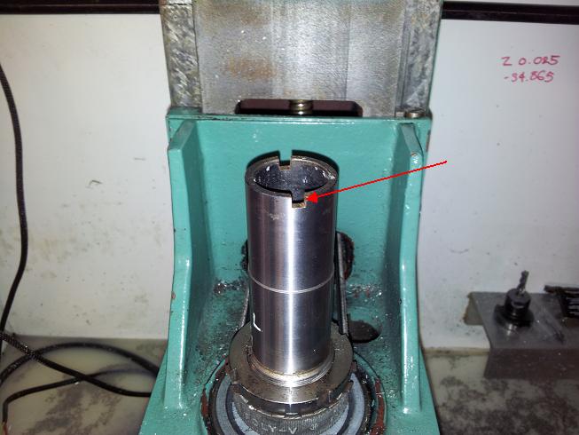

I also wonder if anyone knows if there is a proper tool that locates into the slots (pictured) in the top of the spindle in order to secure it when tightening the collar?
I have so far managed to put a flat bar between the slots and tightened the collar up pretty tightly however I can only think that it needs to be tighter in order to secure the spindle and prevent any movement at all in an effort to remove the "swirls". I don't want to just rant it up and end up damaging the new bearings.
