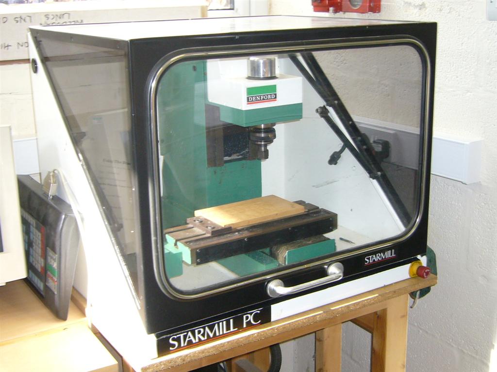

Me back again. I think I have now sorted out the cables for our starmill and I booted from a win98 dos boot floppy. I got a screen full of messages about softwareand drivers being loaded. Fine until message 'initialising mint3.28' followed by flashing curser - dead stop. Should our machine - it is a reconditioned ex demo from 1995 Starmill PC T/E be able to run on win 98 dos or do I need an earlier dos. Help
Keith :(
Picture of our Starmill
Posts: 1924
Post by Martin » Wed 03 Oct , 2007 19:47 pm
It looks like you have plugged a RS232 lead into the desk top tutor. It needs to be a pin to pin or 9 to 25 way converter.
It may be easier to try swapping the RS232 lead between com1 & com2.
You do not need the desk top tutor connected at this point. If the RS232 is correct then the machine control window will open. At this point you can connect the desk top tutor in the other com port.
Novamill to Pc = RS232 changeover lead
Desk top tutir to Pc = 25 to 25 or 9 to 25 way converter.
