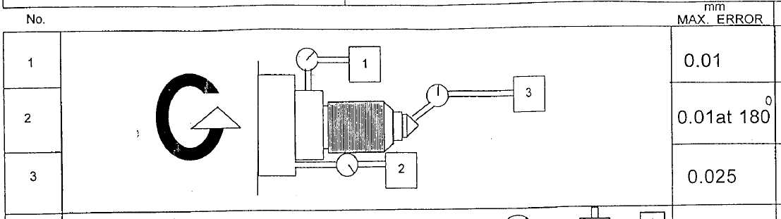

Post by Martin » Tue 19 Apr , 2011 9:59 am
I can't find any info for the Starmill but managed to locate this for a lathe which should be similar.

Post by paragon » Tue 19 Apr , 2011 13:25 pm
Thanks very much for the info Martin, very much appreciated :-)
