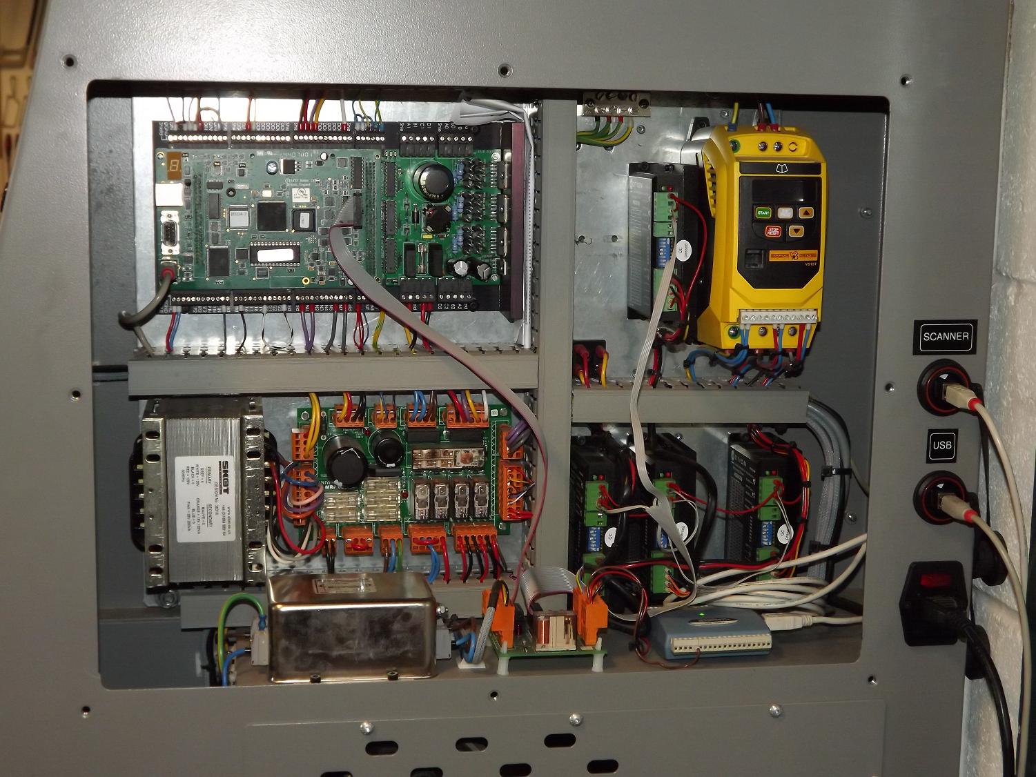

Can you post a photo of the inside of the electrical cabinet ?
I think this is related to electrical noise when the spindle starts up.

Hi. Thanks for quick reply.
Please find attached a photo of the electrical cabinet as requested.

As Admin suggests the PC is loosing communication and this is most likely caused by electrical noise when the spindle starts.
There are a few things that could help with this.
Is the machine plugged directly to a wall socket? if not try doing this, any extensions could cause a volt drop when the spindle starts.
Is the computer located close to the machine and using the standard USB cable?
The USB cable should not be longer than 2M and must not be wrapped around the mains lead or other cables.
Internal to the machine you can see the USB cable connected to the bottom left of the controller card. Could you unplug this and try connecting directly from the Computer to the controller and see if this improves things.
The USB cable inside the cabinet is running inside the trunking, if you remove the lid you could remove the cable and run it along the bottom of the cabinet as far away from the yellow spindle drive as possible. This may help.

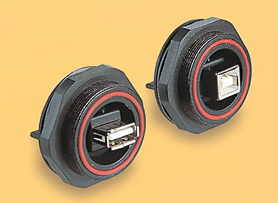

I took your advice and removed the USB connectors located on the side of the machine out of the equation, the USB cables now go directly from the PC into the internal USB connectors inside the machine.
Since I have done this the machine has worked without problems.
The only drawback is that I now have two holes in the side of the machine where the USB cables run through; I'll laser cut some acrylic disks with a hole in the middle for the cable to blank them off.
I'm not by the machine at the moment so have included a stock photo of the USB bulk head connectors that I have removed just in case you don't understand what I have done.
Thanks for your help.

Re: 2600 Pro keeps stopping!
Thanks for the update.
I remember the earlier USB bulkhead adaptors breaking in the middle...
The more connectors and adaptors you go through, the less reliable it's going to be. So I think you're best sticking with your current fix and blanking the holes off.
