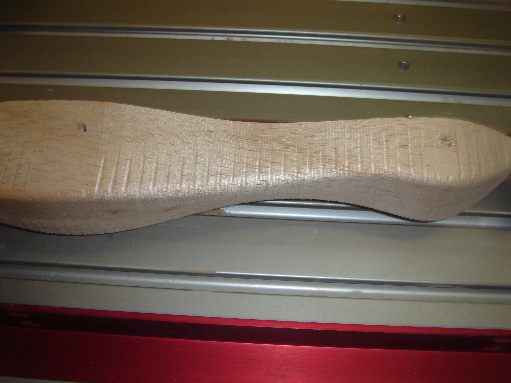

Do you know why we get this type of machine marks on the left side of our CO2 dragsters and F1 cars? It is really strange. The Pitsco blanks are off by .5mm on the 42mm width. The y-offset is ok.
We have been machining the cars using 2 machining plans (raster roughing at 80% and raster finishing @ 10%).
Any thoughts?
Uneven cutting with Router 2600 Pro
- DSC04911.jpg (1.29 MiB) Viewed 7276 times
When you are roughing the tool may be flexing slightly due to the bigger cut or billet deflection.
When you are doing the roughing cut in the cut plan set the finishing allowance to 1mm.
This will leave a minimum thickness of 1mm over the model to be removed by the finishing pass (where finishing allowance is set to 0)
If you do this it should resolve the problem

I dont understand why you use the the different roughing and finishing offsets.
Simply allowing a 1mm finishing allowance on the roughing pass will resolve the problems.
Raising the z offset will leave 3mm material on the top of the part but not change anything down the sides
The tool will still touch and make the marks
The flexing I mentioned was partly due to the tool but mainly the material.
When taking a bigger cut the tool is pulling the material towards it and can leave marks as shown above.
The finishing allowance option will leave 1mm over the whole surface of the model (effectivley scaling it up 1mm) so while the makrs will be visible they will be removed by the finishing pass.
