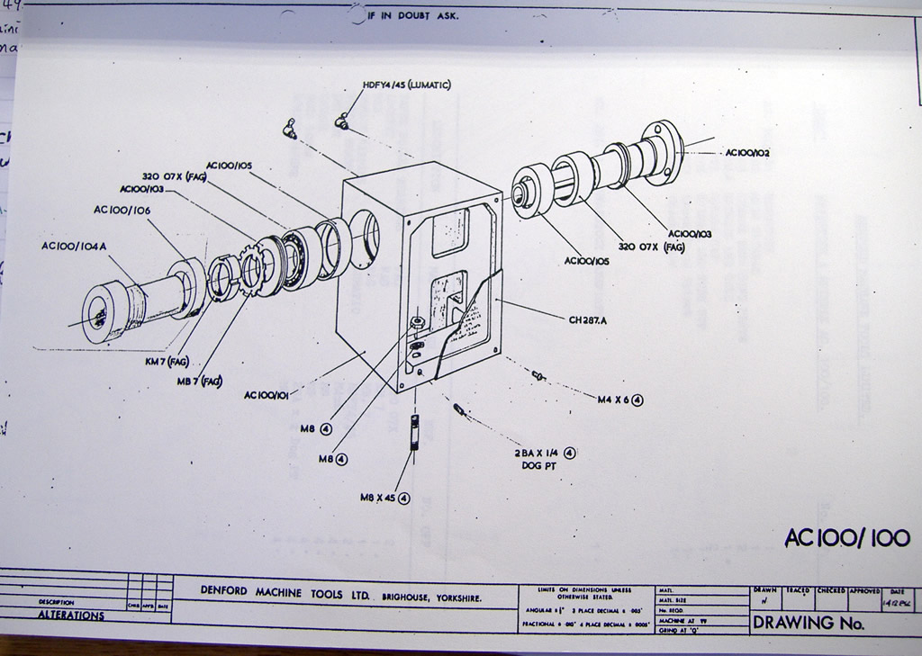

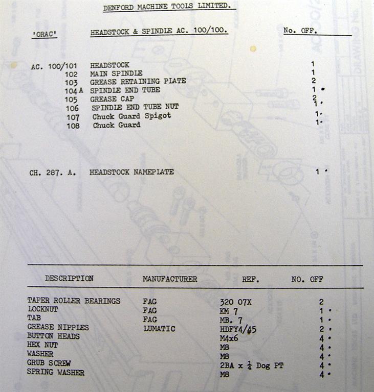

Post by Denford Admin » Fri 29 Sep , 2006 13:48 pm
Maybe this will help ???
Orac Headstock and spindle assembly drawing
Orac Headstock and spindle assembly parts list

Denford admin beat me to it - I've got a copy of the same manual here - actually came from Denford about 4 years ago!

Hi, Duh, I've read the specs (after I posted the last) and the bearings are taper roller.
So when I tightened the shaft lock nut why didn't the shaft become stiffer to turn?
Also I've been reading the info on the SKF website and they recommend that a preload should be placed on the taper roller set.
If that is the case then my head bearings are slack as hell.
Could anyone inform me of the correct procedure for setting up the spindle head bearings?
