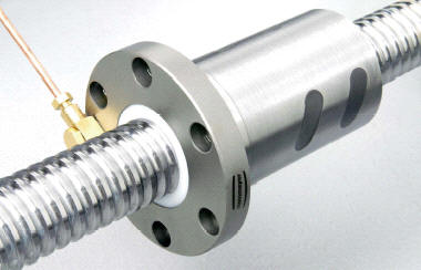

Can anyone help me - I have just purchased a 1988 Orac and thanks to the interesting posts on this site. I have got it working from my PC using the Denford Orac DOS software. I can communicate both ways and I have tried out some of the test pieces quite successfully. I have oiled and greased everything that I can see should be lubricated - however where do I find the Ball screws that it mentions in the manual? I cannot find a diagram of the lubrication points in the manual. Excuse my ignorance about this matter i am new to CNC lathes. Also does anyone know if i can get a set of the original cutting tools for the Orac. Mine came with two tool bits - one round nose and one knife edge - in the DOS simulation program it shows the different profiles of the cutting edges i wondered if they are still available or whether there is a similar set for a more modern machine that I could use.

Hi, I can't be exact as I don't know the machine, but you will find them hiding behind the slideway covers / bellows (if it had any ?)
The oiling point may be some place away from the nut, and fed by copper pipe (see photo of generic ballscrew and nut)

A ballscrew and nut !
