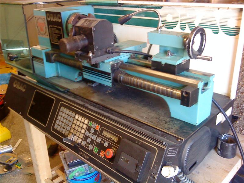

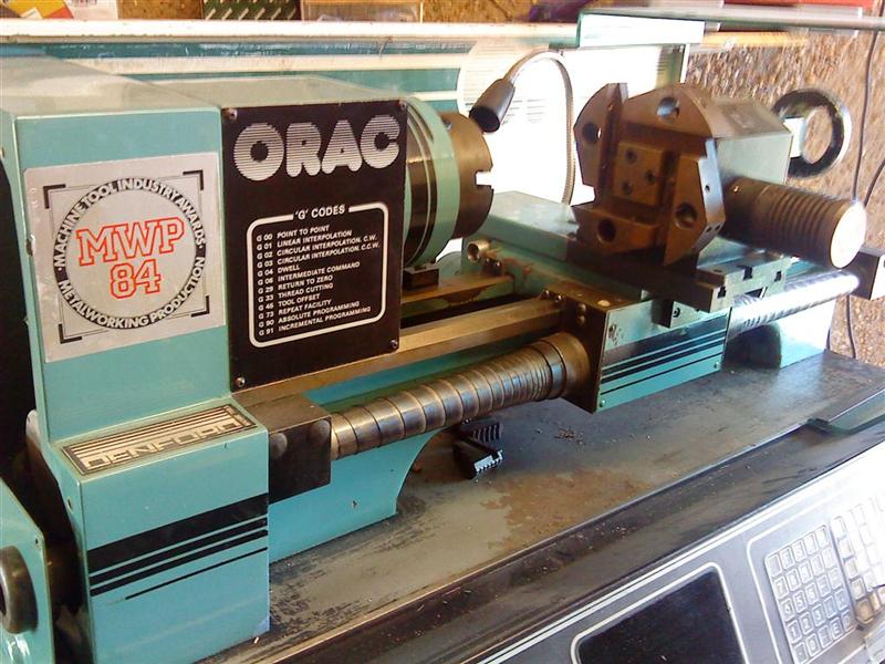

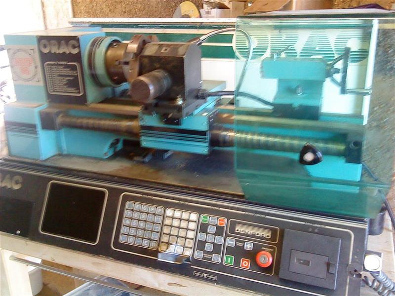

Ok managed to upload a few pics. As you can see the lathe is in great condition apart from the slight tear on the keyboard cover. Both screws and motors run very nicely.
O and it has an automatic tool changer which I believe are near impossible to find these days! I also have a regular quick tool post changer.
Since the pics have been taken out I have removed the electrical innards. I am planning to run the spindle motor off a 3 phase invertor (probably from ebay). I was thinking about making my own custom power supply or potentially buying one, depending on which works out to be cheaper. Stepper controller wise I'm looking to use the stepper controllers and uniport breakout board from zapp automation. Quick question, am I right in thinking that the steppers originally ran off 72V? Can't remember where I seen the figure but 72 rings a bell.
I'm planning on squeezing a PC in the space under the lathe, along with everything else. As am likely to be machining steels and titanium I will be installing a coolant pump. Flat screen monitor (touchscreen if i want to be really fancy) with mach 3 controlling the lot.
Another thing I was wondering is how the tool changer interfaced with the original electronics and how easy it's going to be to interface to mach 3?
O and funnily enough I was aware of Orac the computer although I didn't realise that the two were connected! :)

Post by Denford Admin » Tue 23 Feb , 2010 11:01 am
I presume you are able to control IO logic with Mach3, so it should be an easy job.
It looks like the Turret is an older version of what we still supplied on the Novaturns.
You just need to run the motor around (Direction1), looking at the bit pattern coming back from the tool sensor. When you see the correct tool number, reverse the motor (and keep it reversed)
Keeping it reversed holds the turret in position (Its a ratchet gear and pawl/clicker mechanism inside, see this: https://en.wikipedia.org/wiki/Ratchet_(device) )
