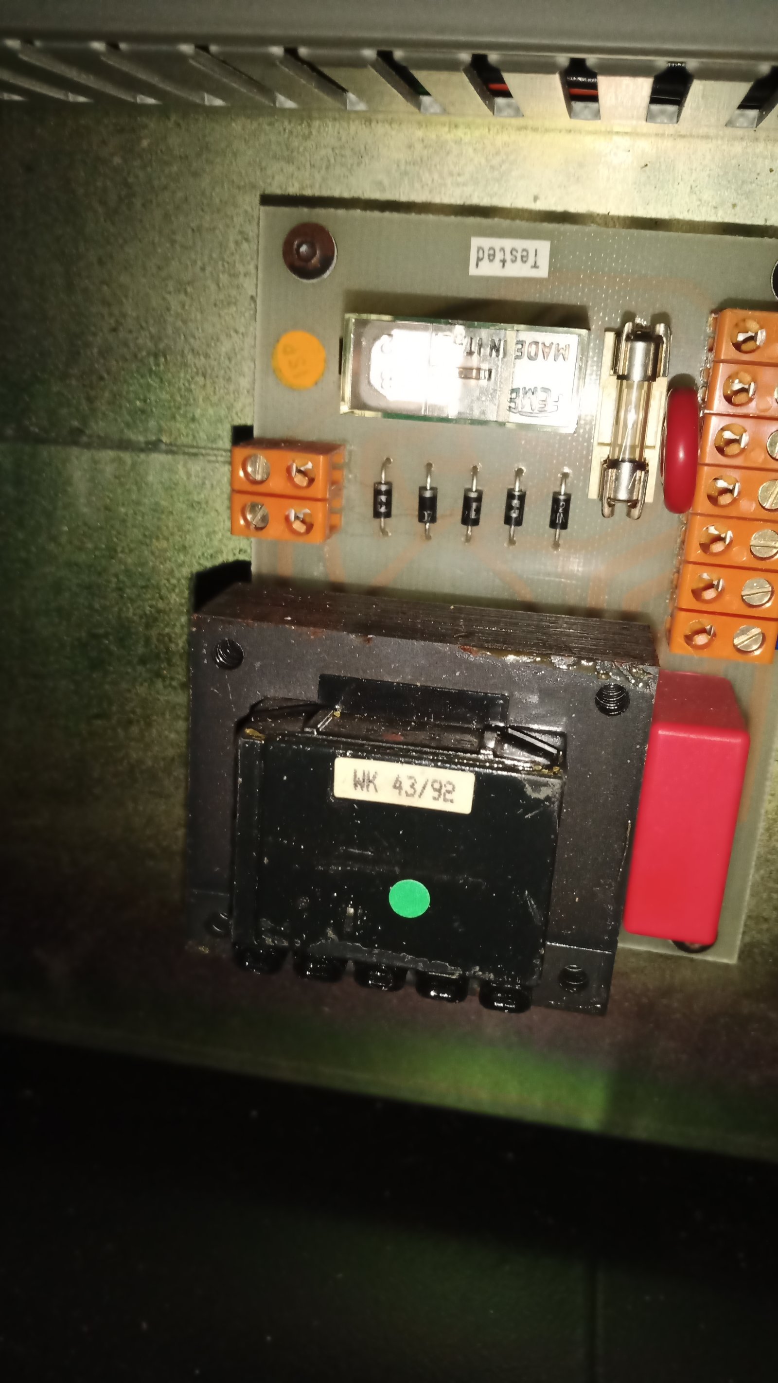

i found this pic of the Turn 270/Novaturn ATC psu. The psu is a simple unit, Transformer, a small bridge rect, voltage reg, a few caps, relay, fuse and what looks to be a 4 diode bridge and a 5th diode possibly to deal with back emf from the coil, the 6th diode im not sure on.
Interesting it states the fuse is a 3.15A T (slow blow)
https://www.denfordata.com/bb/viewtopic.php?f=42&t=2293

thanks for that pete! I am really wondering what the fuse is protecting, and if it is before or after the transformer. If it is just before the motor, I will try just a slightly higher rated fuse, but if is before the trans, then I wont experiment with that. Guess I will take it off and make a diagram tonight perhaps. Not sure if I will get into hot water for posting a picture of that...
- Posts: 613
Re: Novaturn ATC blowing fuse on startup
I'm in the garage tomorrow and will try to get to my black box, ill pop the fuse and see whats in mine.

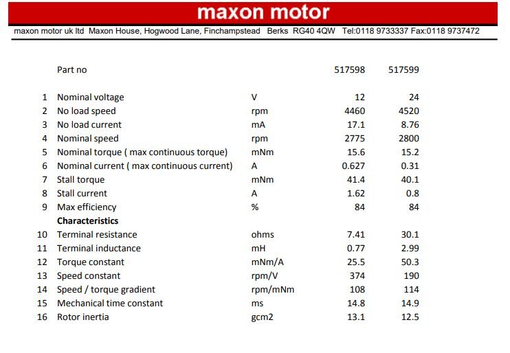

Hi, I got a look at my black box... the bad news is the fuse in mine IS as 500mA fast blow!
I have just found these specs which i believe to be correct for the 24v motor. (it has the 12v motor too)
I'm trying to remember about how they are wired. I know the cables for the motor run down through the gear box so you need to be careful about them as only really fine wires. This I think was a Denford modification so that the motor/gearbox could be fitted in the external heatsink/case. Now I cant remember what that went to in order for it to then be connected to the cable that on my machine plugged in near the head stock. i do remember having to unsolder the motor so I could strip it to replace the gear box.
So given this information I could check all the cables, I wonder if one has worn through the sleeve possibly in the motor case over time.
