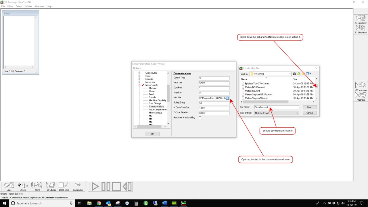

If you open up VRTurning & then open up the Setup Parameters (password is denny) you will need to change the mint file in communications for the Novaturn NS. It should read
C:\Program Files (x86)\Denford\VRTurning\NovaTurnNS.mnt
& not
C:\Program Files (x86)\Denford\VRTurning\NovaTurn.mnt

Re: nova turn software issue
Post by Steve » Mon 10 Jun , 2019 17:32 pm

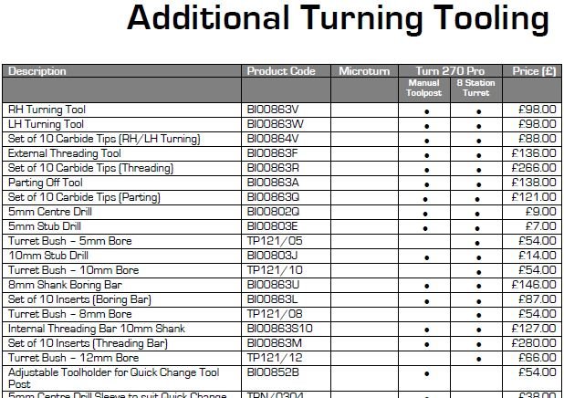

Any advice on where to buy tools would be greatly appreciated! I need a boring tool and parting tool.

Post by Steve » Tue 25 Jun , 2019 12:33 pm
tooling is available from Denford.
