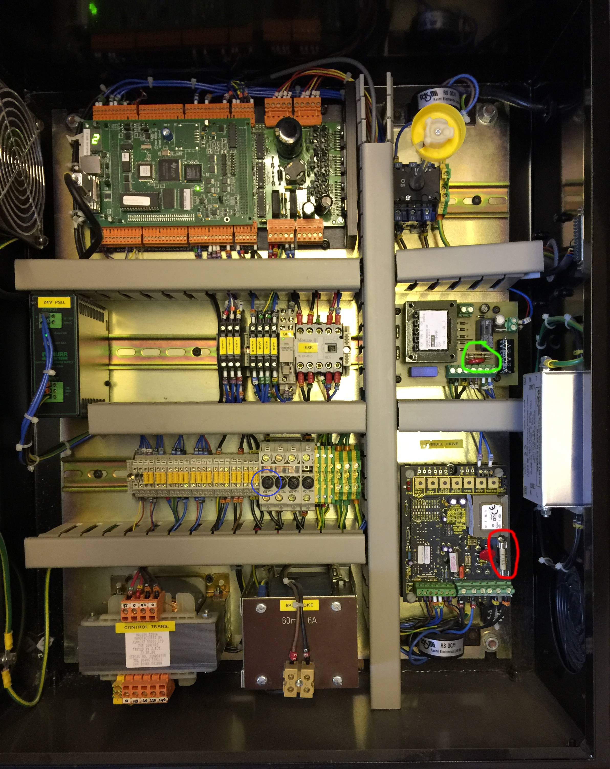

Can you check the spindle drive in the electrical cabinet. It should be a Sprint 1200 & with power on there should be a red led lit. The drive has a ceramic 1 1/4" fuse on it & there is also a 20mm fuse on the din rail that you need to check if the led is not lit.

Post by Jaffacookie » Fri 22 Apr , 2016 16:39 pm
OK so the red LED is not lit.
https://imgur.com/a/eAj19
Are the 2 fuses I have circled in Red and Green the fuses you are referring to? If so are they easily purchased?

Post by Martin » Tue 26 Apr , 2016 15:36 pm
The one circled in red is a 16 Amp 1 1/4" ceramic fuse on the spindle drive.
The one you circled in green is for the ATC motor.
I have circled the other spindle drive fuse in blue. Fuse F1 10 Amp 20mm.
