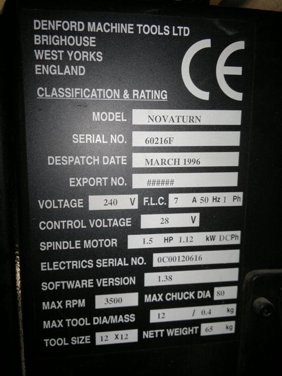

Having got to grips with my novamill (which is excellent by the way), i've taken the next step and got a novaturn on the basis that the flstep software was availble here. I've read the forum fairly thoroughly but cant seem to get FLSTEP to connect to the novaturn.
The novaturn seems to power up as per my novamill, the 7 segment display displays 0, L (flashing dot), 8 then the machine powers up and you hear the faint hissing sound from the machine as per the novamill.

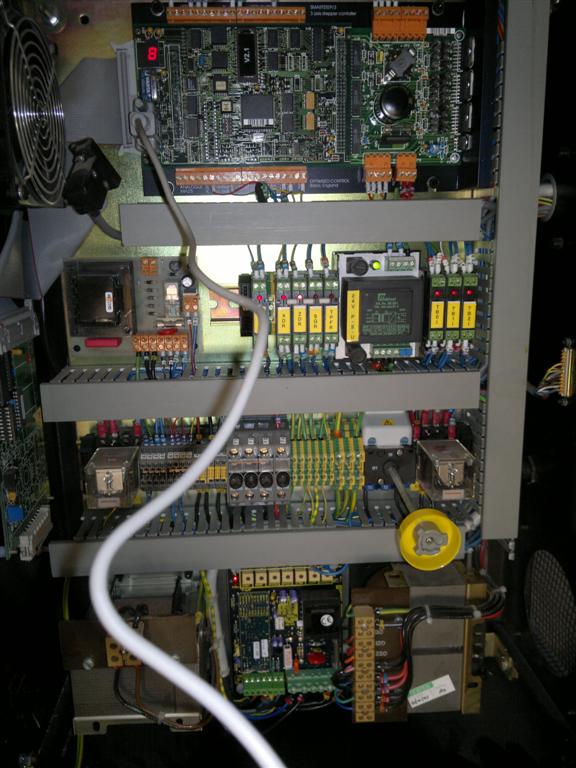

Some other pics are provided for info below.

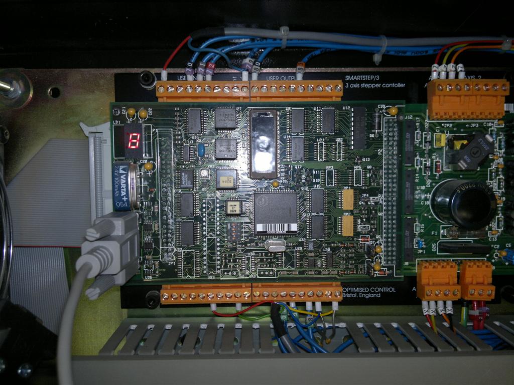

As an aside the main control card looks identical to my novamill, it even has a later standard eeprom than the novamill at v2.1, does this mean its been upgaded to work with vrturning?

novaturn info
novaturn info
control board close up
null modem connection

It's more than likely the wrong cable.
Use this post to check the RS232 wiring from the PC direct to the board...
viewtopic.php?f=54&t=544

Oh and yes it looks like its been upgraded to run from VR Turning...
Re: Novaturn anf FLSTEP
Yes, The Eprom looks to be version 2.1 so therfore the dos software will not connect. It should be VRTurning unless you can find the Dos Eprom.

An old V1.6 EEPROM that came in a box of bits with my Novamill (compatible with FLSTEP) helped alot and Dosbox is essential, otherwise you get intermittent comms issues.
