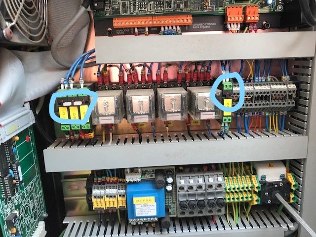

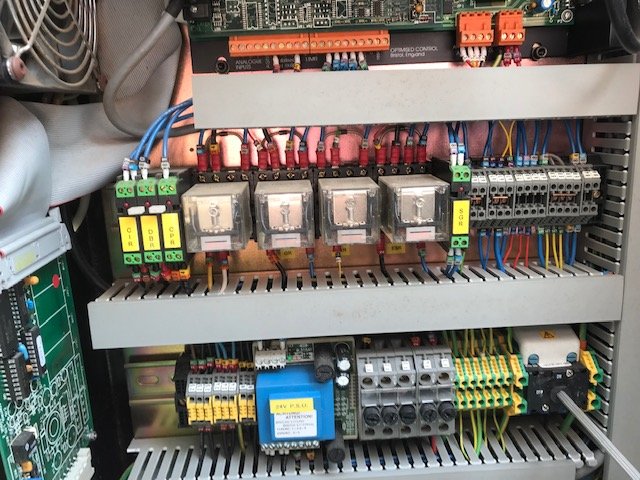

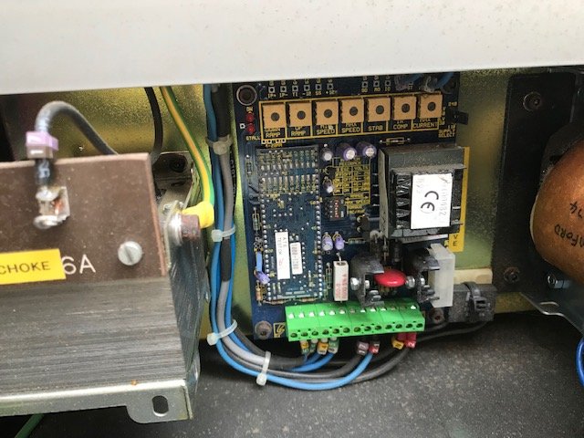

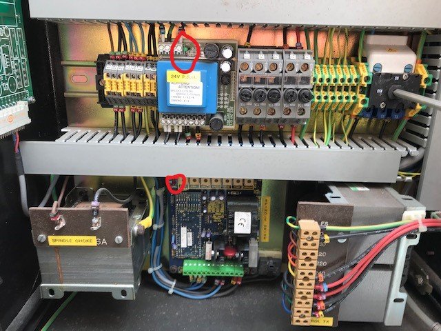

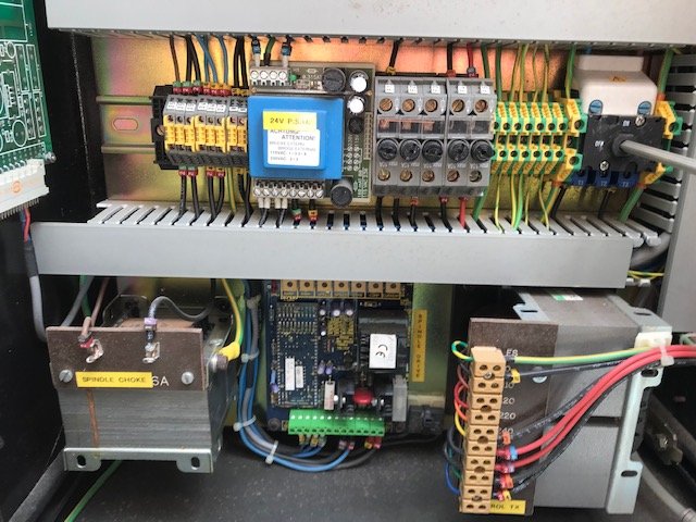

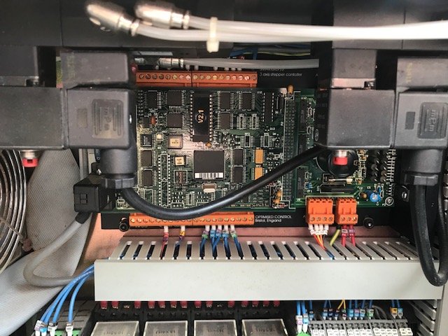

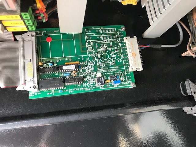

I have checked the fuses all OK there, The unit does unlock the cover guard when switched on.
I have added some pictures not really sure if they are the ones you need.
the second image is marked where the LED's illuminate. The blue PSU 24v illuminates and the board at the bottom and the board marked spindle drive illuminates with a faint red glow.

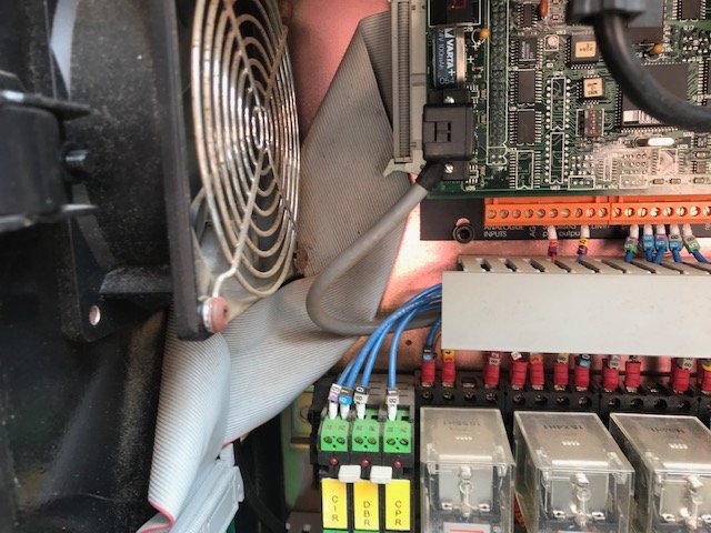

I have just gone through the whole cabinet and the following relay items are unlit also.
CPR
DBR
CIR
SGR
https://photos.google.com/photo/AF1Qip ... qG419WfpB
don't know what the abbreviations stand for either
CPR
DBR
CIR
SGR

The abriviations are Spindle Go Relay drawbar Relay carocel power and carocel in

Hi. Are there any LEDs lit on the controller card? Also is the 7 segment display lit? Have you checked the fuse on the controller card?
There should be a couple of small flashing leds and the 7 set must be lit.

No LED's on the controller card and 7 segment display not lit.
There is 21 volts to a number of pins on the board but no signs of life to the mill.
Battery on the control board is OK and all fuses are OK in the complete system.

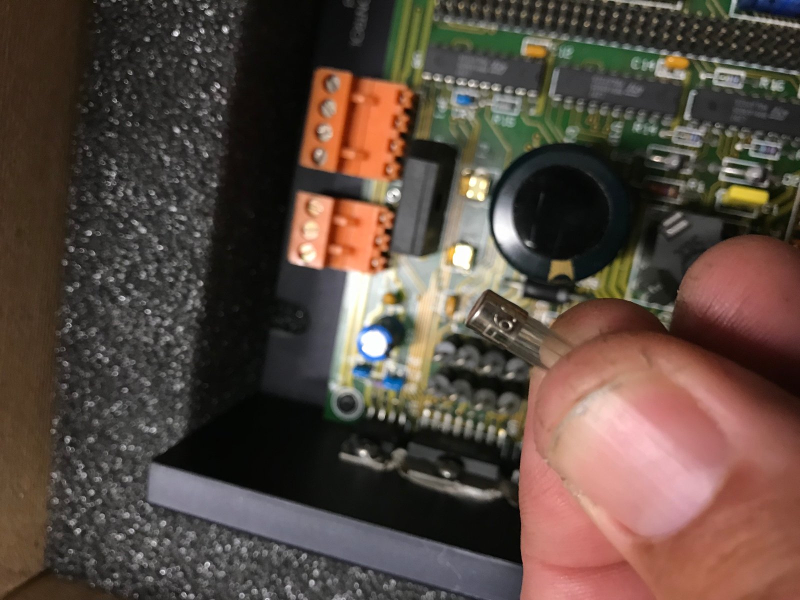

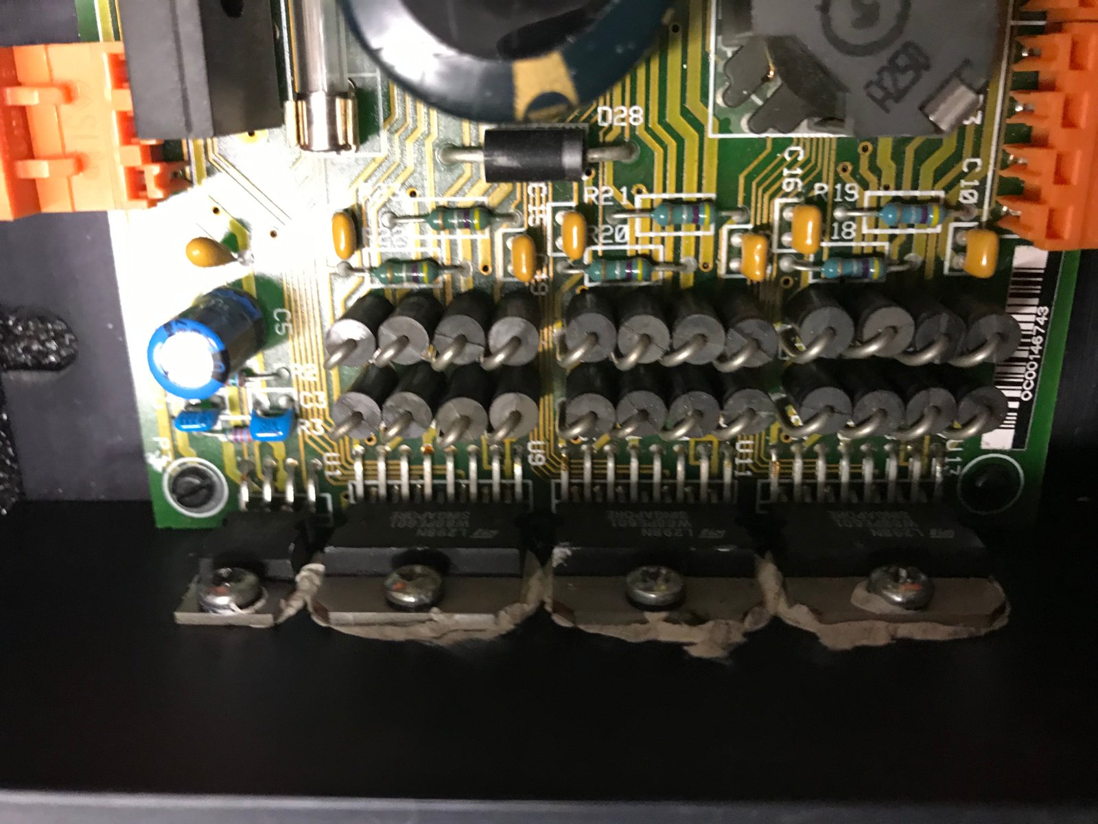

1) David the board that you mentioned has no power at all 5v or otherwise........But going back to the fuses, I did a visual and a continuity test with the meter when i first obtained the machine last week, they were the original fuses and two were blown, i replaced all the blown fuses which got me to this stage.
After reading David's message and checking for the voltage (I still can't get my head around the logic bit)
but i checked the fuses again and found the one on the control board blown again, I changed it a second time for it to blow out immediately. I am now thinking that maybe the incorrect fuses were in there in the first place as i only replace like for like.
Would this fuse blowing cause the problems i have been experiencing?
Could you advise which are the correct fuses to use.

Which fuse has blown and what value is it.
I suspect it is the 24v supply to the smart step control card.
Unplug all the connectors other than the 3 way one in the bottom right of the controller then replacement the fuse and power on. Does the fuse still blow?
If not start plugging connectors in one by one and powering on each time to find the faulty one.

Hi Steve
It is the Smart Step control card fuse.
I have disconnected all plugs apart from the 3 way replaced the fuse but still blows.This time the 7 Segment display lights up momentarily.
The fuses are "Littelfuse, 80mA Glass Cartridge Fuse, 5 x 20mm, Speed T 250v" replaced with the same from RS-Components part No.:541-4151.
Re: My Novamill won't run
Hi, The fuse on the board supplies the regulator and stepper motors so an 80mA fuse is far too small and will blow.
I have checked a smartstep card here and the fuse fitted is a 6.3A F rated fuse (Quick Blow).
Fit the correct fuse and all may be resolved. If the fuse still blows with the connectors unplugged then can you check the stepper motor drive chips and regulator for signs of damage. If a stepper drive has a fault or the stepper motor wires are shorted out it will blow this fuse.
See pictures attached showing fuse and driver chips attached to the heatsink
