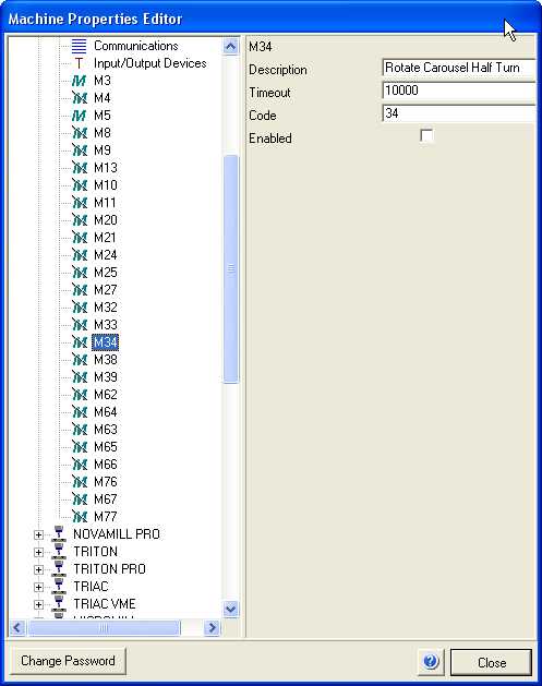

There is an M code to do all the toolchanger functions.
If you go into setup and look at the machine capability it lists them all.
M34 indexes half a pocket.
Once it is in position index to pos 1 and reteach.

Thank you Steve worked straight away :loads-a-money: :P
