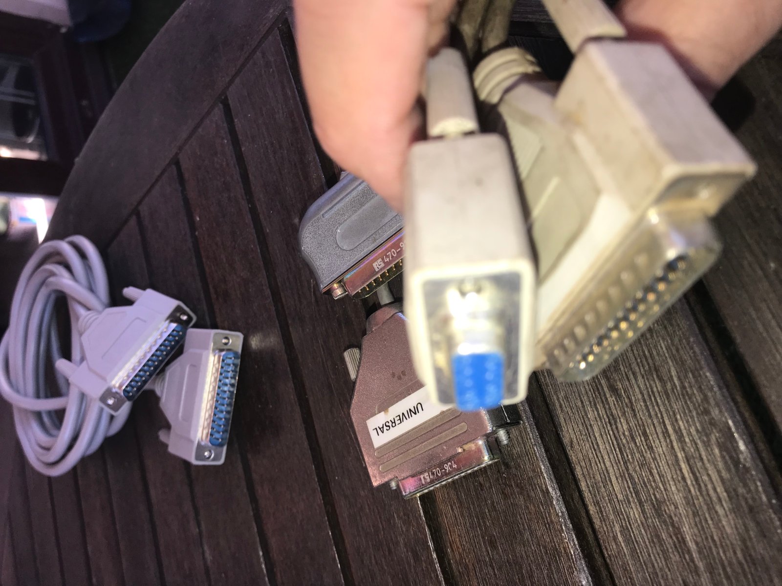

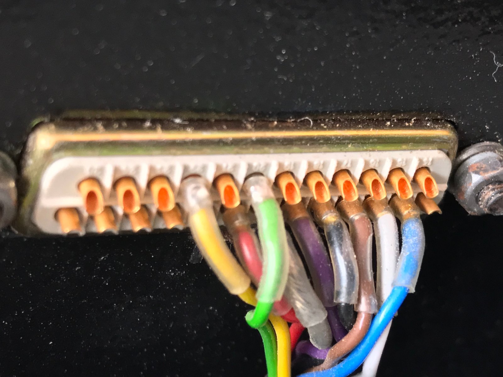

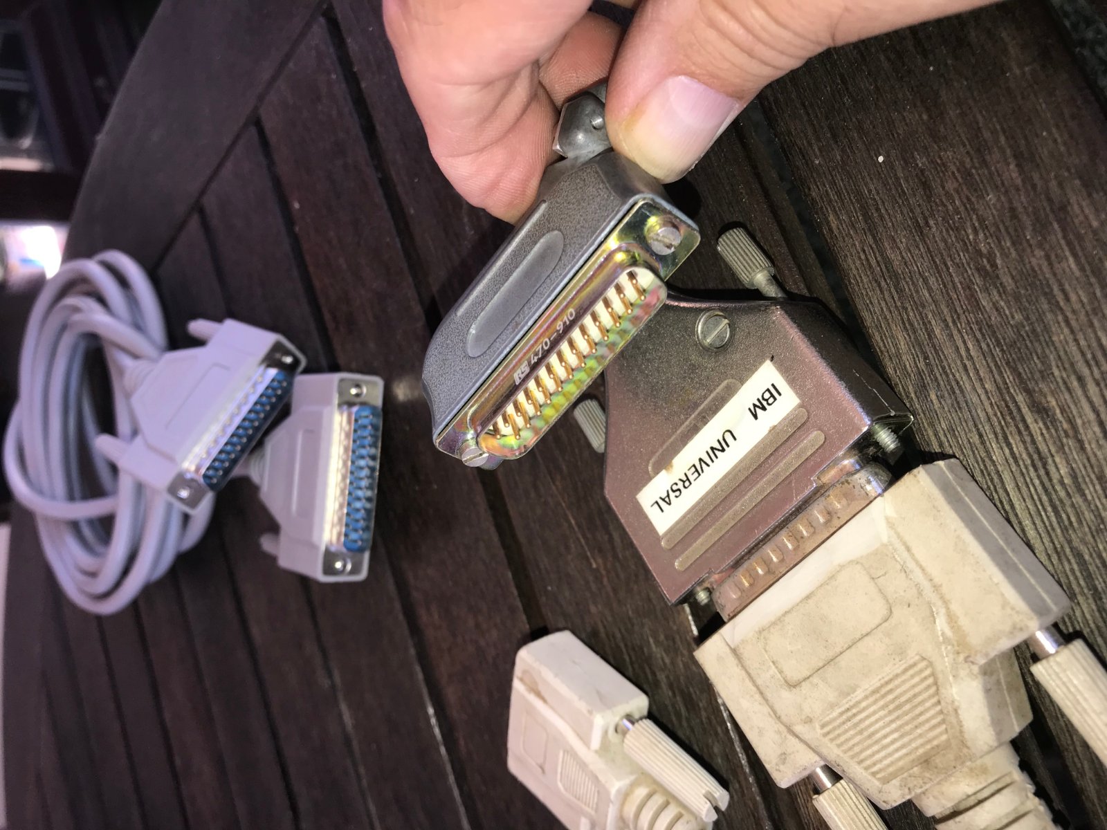

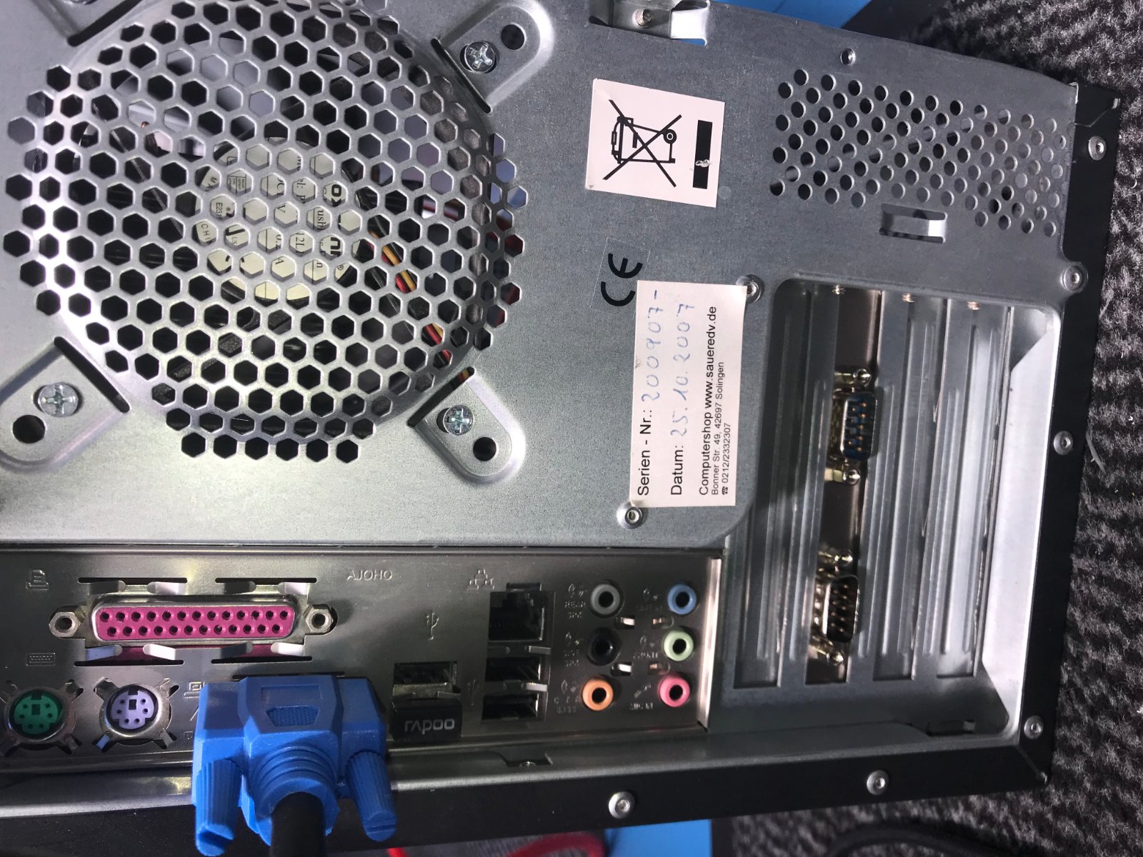

I've attached some photos of the cables supplied no black ones i'm afraid and I've listed the pin connections hope it makes sense.
Pressed metal housing of the cable from the ATC to the 9 pin conversion cable
Rear of the computer Com 1 was originally the 25 pin connector
output wiring on the ATC
Grey cable supplied with pressed metal housings.
Pin Configuration 25 pin to 25 pin
Computer Male end.......ATC female end
pin 2 ........................Pin 3
3...............................2
4...............................5
5...............................4
6 looped with 20............6 looped to 20 + 8
7 Gnd.........................7 Gnd
I'm not sure whether this cable is configured correctly
Stepper card cable
9 pin to 25 pin cable
At Card----------------ATC Out
Pin 1.................Pin 8
2.........................3
3.........................2
4.........................20
5 Gnd...................7 Gnd
6.........................6
7.........................4
8.........................5
9.........................22

On the pic of the computer rear panel, the Purple 25way is not an RS232 port, that is a parallel port (unless you are referring to one that is not in the pic) The 2 9 way D type are the RS232, so you need to make sure you have them set up and can work out which is which.
The one that you call Stepper card cable 9-25 way looks to match up with the pin outs on the mill case connector, however it all depends if pins 2 and 3 are correct way round (TX/RX data often an issue)
I would be using this one and making sure the RS232 ports on the PC are set up correctly. If you open the PC case have a look if the 9ways are on a full card or just link cables back to the motherboard, either way look at where the connections are on the Card or mobo, they should be labelled Com1 and Com2. Ensure you use com 1 and set up the bios and software the same.
The IBM universal cable (metal cases) looks to be a 25 way version but rather than have the data lines connected at each end to allow full communication for PC to Mill it has loop backs, often done to save on the numbers of cores used in the cable.

i was using the 9 pin on the computer they are part off an expansion card dedicated to these two ports, i'll have to spend a while and configure these within the computer it self and then get back to you.

I'm at a bit of a halt at the moment i discovered my computer is not recognising my RS232 port and defines it as a parallel port. i'm waiting on a new adaptor to see if that cures the problem failing that i'll have to get hold of an older computer with the RS232 port on the motherboard.
