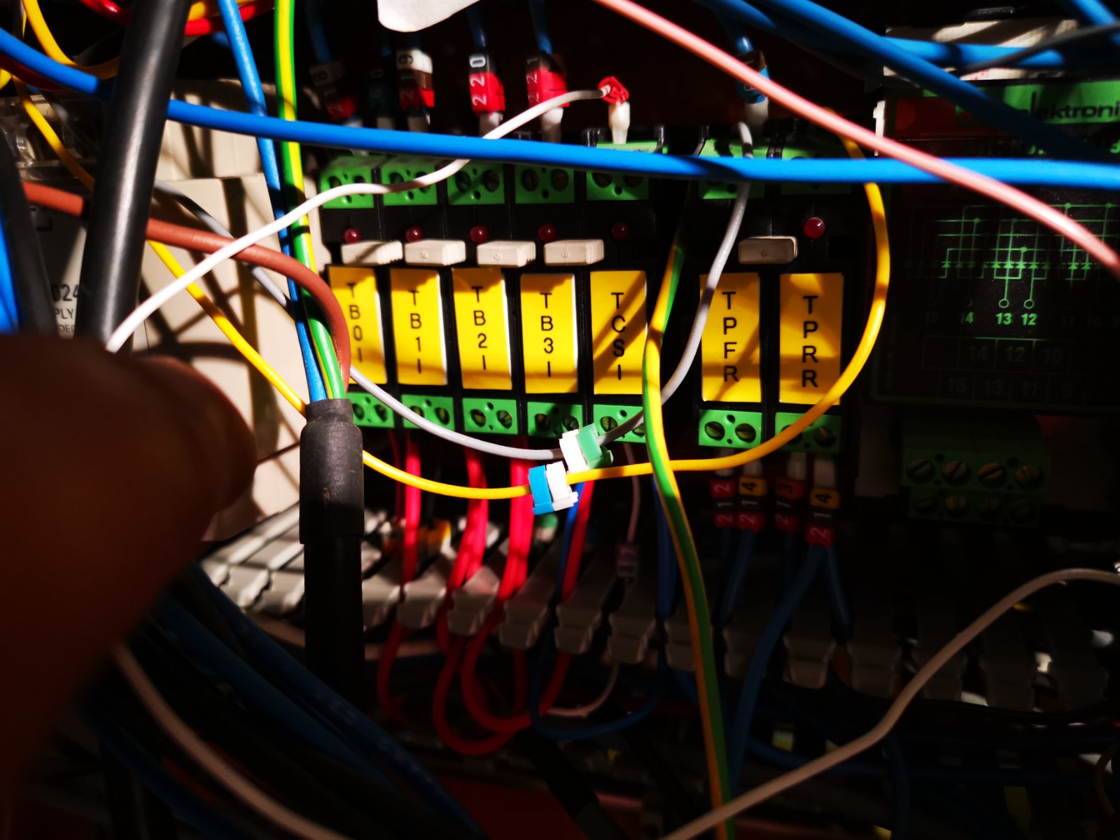

hello everyone hope to get some help i am upgrading my denford mirac lathe marked in 1997 i chose MASOO G3 for my upgrade so i am having trouble with my ATC i chose 4BITS tool changer could you please guide me if i chose changer Right? Well regardless of whether I chose well this is what is happening, the turret makes the changes only that the 4-bit codes do not seem to be correct and the binary numbers do not match, I made a list of the LEDs that turn on every time I select a tool , I will leave some photos of my list and of the turret that I have also there is a gyro encoder behind the turret.

hello iron man, sorry for taking time to respond, my turret is a DM8 these turrets do not have an encoder for each position, instead they have a rotary selector with 8 signals that go out and go to a diode module, I leave you a photo .Image

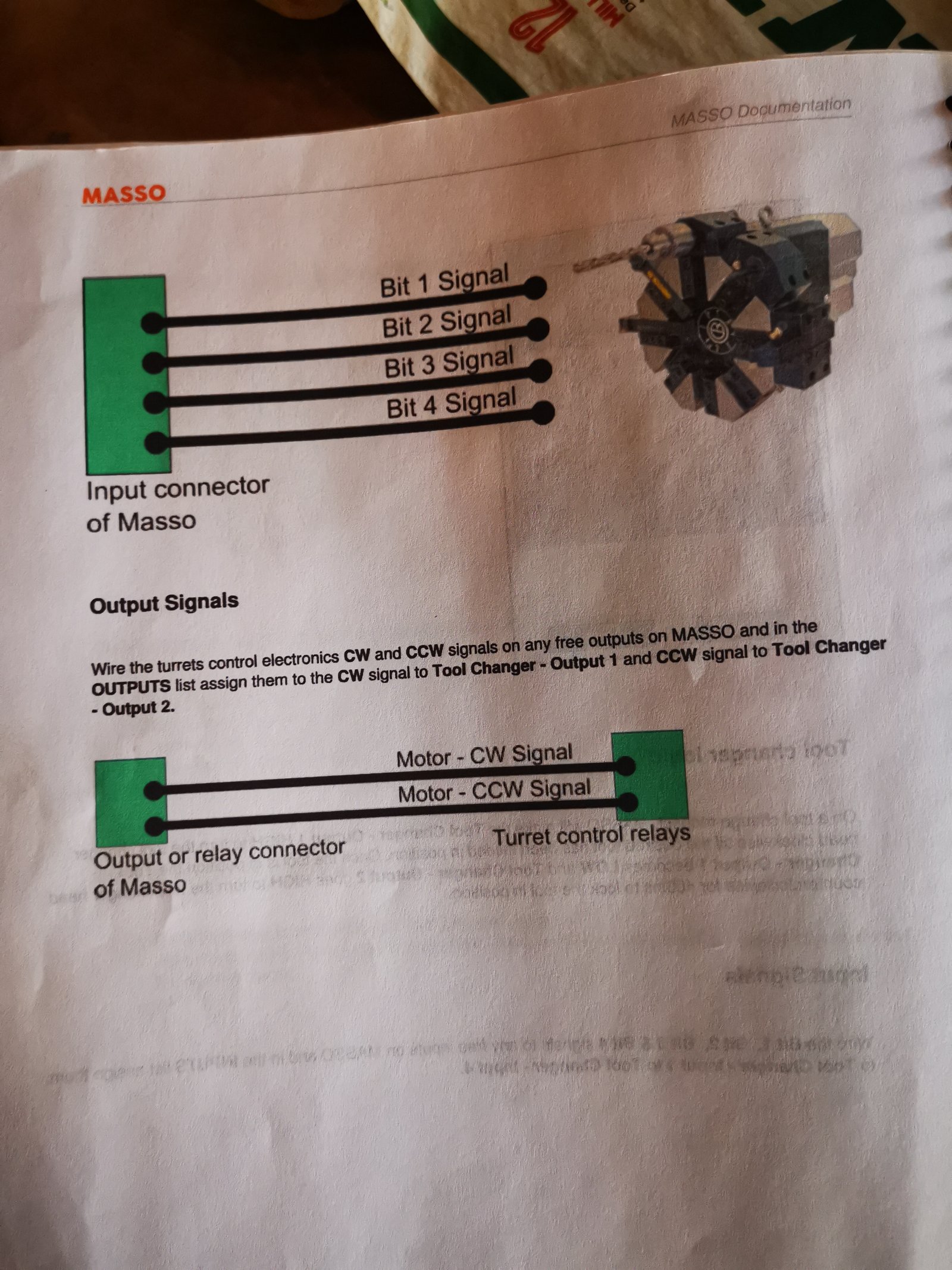

From MASSO: EMCOturn 120
Input Signal Sequence Chart
Wire the sensor inputs and assign to MASSO as below:
Tool Changer - Input 1 for Turret signal-1
Tool Changer - Input 2 for Turret signal-2
Tool Changer - Input 3 for Turret signal-3
Tool Changer - Input 4 for Turret signal-4
The below chart shows the signal sequence as per EMCO documentation. Check that your tool turret provides the signals as shown below to work properly with MASSO.
I can check and see if there are any 8 bit to 4 bit converter logic ICs or Priority Encoder ICs available. If not, you could use a pic micro and simply write the software for a conversion. Something like this:

Hello, thanks for answering, I will leave a pdf file of the diode modules and the signals that come out of the turret, I also sent an email to MASSO and this is what they told me:
It seems the problem is being caused by relay timing because relays are mechanical devices and will have small time delays (milliseconds) and this will have a huge impact on logic and in fact with relays it will never work reliably . Also, it is not necessary to have relays in this type of configuration.
Can you connect the diode signals to MASSO directly? We hope this removes the timing issue and your tool changer works fine. do this test and keep using MASSO 4 bit tool logic as it is the best choice for your setup let us know how it goes.
