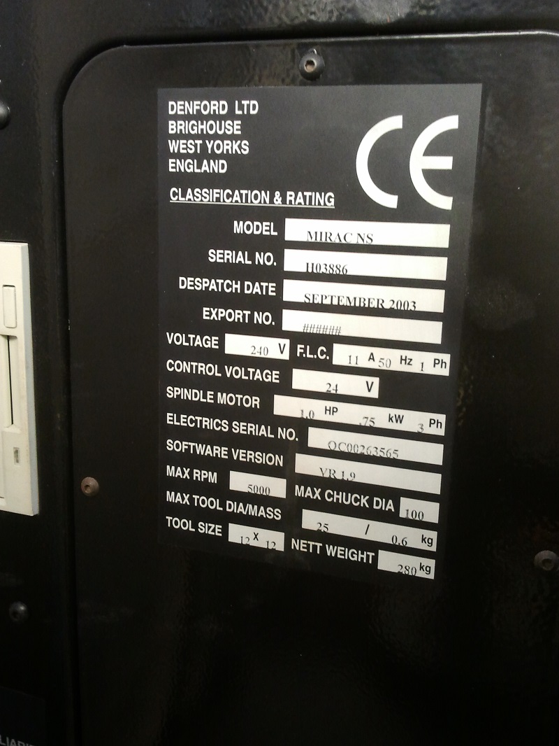

yep I am an idiot !!!! its a 2003 thats the dispatch date sn H03886 electronics sn 0c00263565 ... typical Yorkshire man wouldn't turn the light on in the workshop !!!! if it gets abit darker I may even light the candle . didnt take any photos as the unit is in a corner of the workshop and not easily moved.

Had a weekend sorting out the workshop and managed to move things around , still cant get to the back of the machine , but will post some photos asap the numbers on the side panel are sn H03886 electronics sn 0c00263565.

This is the original spec of the machine.
You can run VRTurning from a more modern PC as long as it has a 'real' serial port and you'll probably need a parallel printer port for the hardware dongle. The dongle could be an issue- getting it to work on anything above XP. A 'flash code' license text can be supplied instead but there is a small charge (contact service
denford
co
uk )
Download the latest version of VRTurning from here:
https://website.denford.ltd.uk/index.php ... -downloads
- H03886.pdf
- (26.17 KiB) Downloaded 1164 times

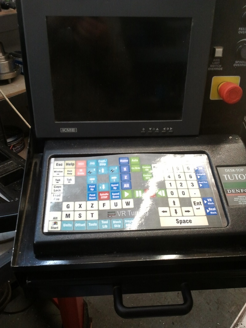

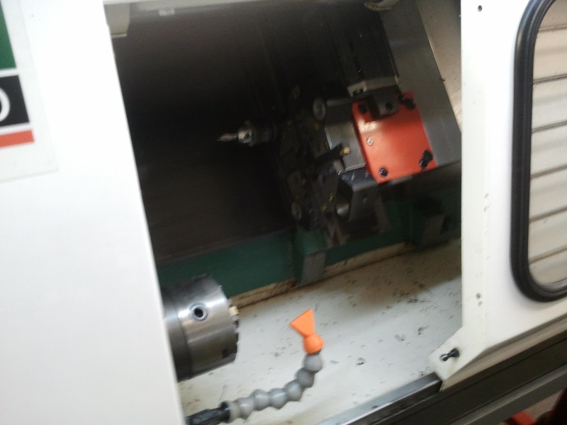

HI Guys
Thanks for the info on the computer side of things may just up the ram and monitor for the time being as its working fine , Please find attached a few snaps , sorry about the quality , taken with my phone as you do ( I shoot film..... sad I know ) , Cant get to the back of the machine yet to photo inside , but will post up photos asap. I have down loaded the vr turn Pdf and working through that so getting a bit more into how it works.
Best regards
Mark
Best regards
Mark
