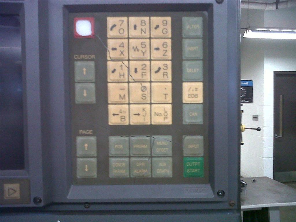

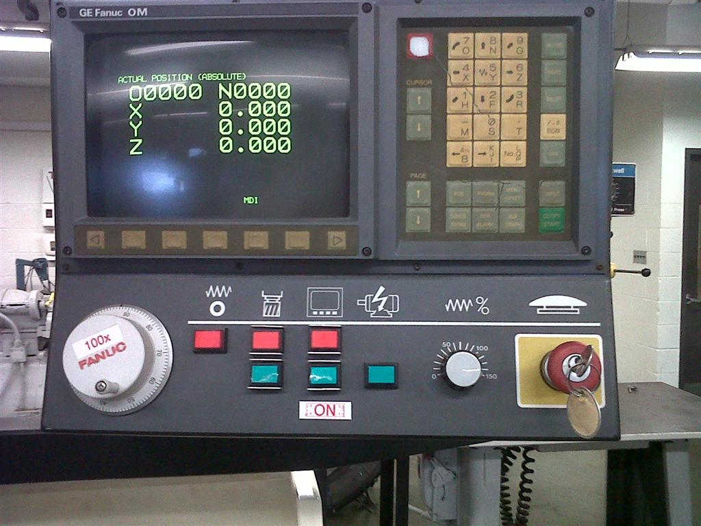

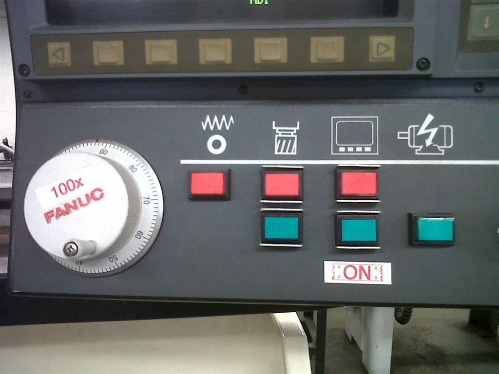

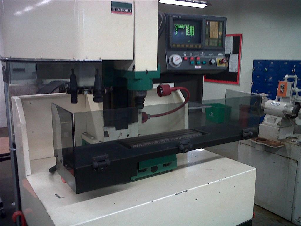

I am working with our local school to bring up a Denford Triac ATC with a Fanuc 0m control. WE currently have the control up and we have loaded the parameters. All the faults are reset and the control is stuck in MDI mode. There is no operator station for this machine and it appears that there never has been one. There are no soft keys on the screen to allow you to change modes or change screens. Fanuc suggested that we locate the Data sheets for this machine. Where can we get this information? Attached are pictures of this machine and the control
