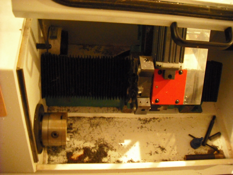

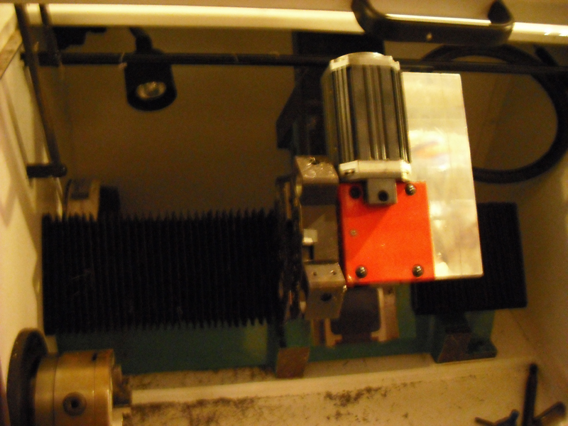

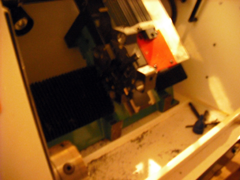

Thanks for the advise. Heres a few pictures of my machine, there not the best as my camera was going flat so my flash wouldnt work.

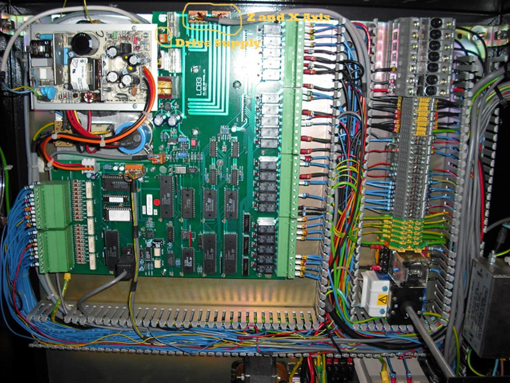

Re: Denford Mirac Electronics Refurbishment
I'm not sure about that - I thought the Miracs would have all been be Baldor control based ?The problem is that the electronics in this lathe only work with DOS software
We should be able to tell if you post a pic of the control cabinet and control card(s)
We used to fit a GSM LCB3 card. Not sure when we changed over to the Baldor.
The control card is an LCB3 and doesn't have any of the Euro control bits and pieces. Either way I wanted it to run on Mach3 as its something im familiar with.

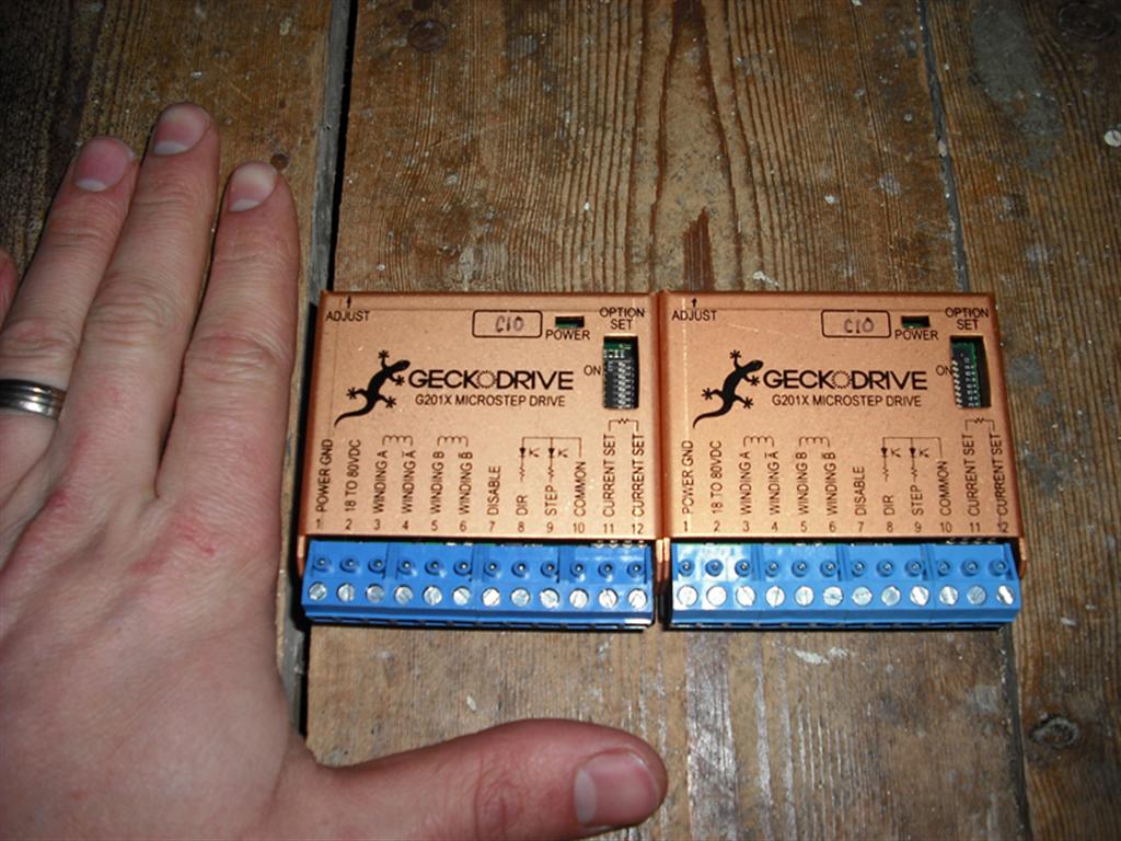

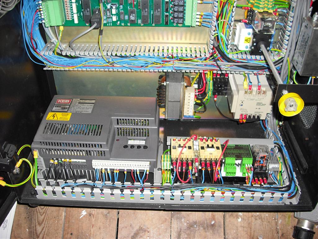

Today I brought the electronic control box home and got the geckos out of their packaging. I was quite shocked how small they are but they seem to be excellent quality. Gecko shipped them very quickly, I received them within 3 days all the way from the US!
Anyway I sat down with the control box and started working out what's what. I have identified the X and Z axis's on the slave board and also the drive supply. I has hoping to work out what voltage the steppers run at by measuring it from the drive supply connector but it seems it does not output any voltage when not connected.
Does anyone happen to know what cables go to what on these steppers. If not can I just work it out by doing a continuity test?
Yes you should find two pairs of wires with the same low resistance reading.Does anyone happen to know what cables go to what on these steppers. If not can I just work it out by doing a continuity test?
I'd guess looking at the photos that if you take the wires off the orange connectors from left to right, you'll have your pairs 1+2;3+4 which will go to 3+4; 5+6 of the Gecko

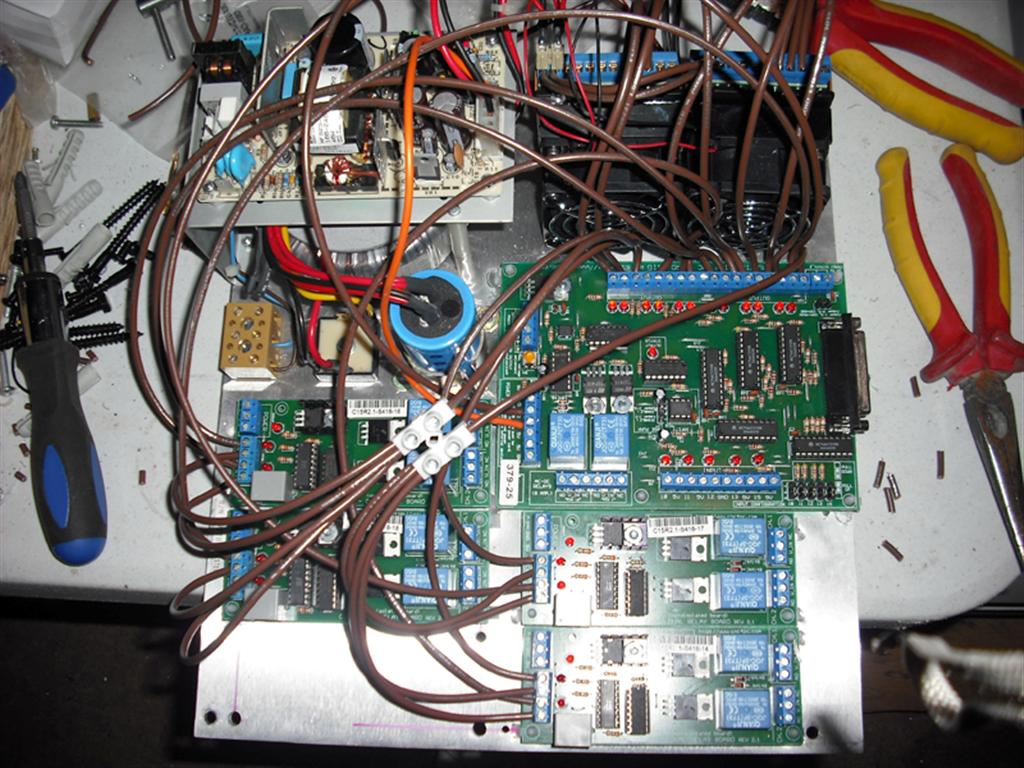

I have made a little progress with the machine today. I worked out that I really needed heat sinks and fans for the Geckos as per the manufactures instructions for currents over 3A. I was told a little while ago that the steppers on the Mirac draw 3.5A under load (I also found out they run at 38V). I purchased 2 of these https://uk.rs-online.com/web/search/sear ... &R=158-556 heat sink and fan assemblies and have fitted them to the Geckos. I removed the slave board and then mounted the heat sinks to the large plate of aluminium where the slave board was.
I had to order 5 C15 Dual Relay boards from CNC4PC. They will be used for enabling the spindle and tool post, running the spindle and tool post in forward or reverse etc
It seems that the spindle and tool post are powered from the motor controller/inverter together and 24V relays are required to turn the contactors off and on to turn the motors off and on. Theres speed control and an encoder for the spindle but doesn't seem to be anything for the tool post other than a DC brake. I'm guessing that the tool post uses a worm drive and runs at a set speed and you just have to time how long you run the motor to get to each tool.

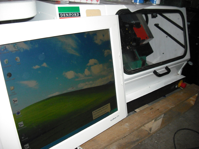

Hi Guys, Sorry its been ages since I've last updated. I've been stuck twiddling my thumbs a little as I am constantly waiting for bits to turn up.
I wired up most the machine. I've managed to get both axis's working, the spindle turning and the tool post turning.
The Control card from CNC4PC is very limited in terms of inputs. I have had to purchase a further Parallel post card and breakoutboard to connect the home and limit switches to.
I'm struggling to get the spindle to turn at the desired speed. It seems to just stay to one constant speed even when using the mach3 tuning tool. I am also struggling to work out which core on the encoder goes to what, i.e are they pairs do they need 5V and Gnd etc
With regards to the tool post, that bit seems to be rather simple, all you need to do is tell mach3 to watch the grey code for the correct tool then stop and reverse then switch back over to the spindle. No voltage need to be applied once is fully locked in, though it wouldn't be possible to apply any constantly anyway as you can only have either the tool post on or the spindle on at any one time.
