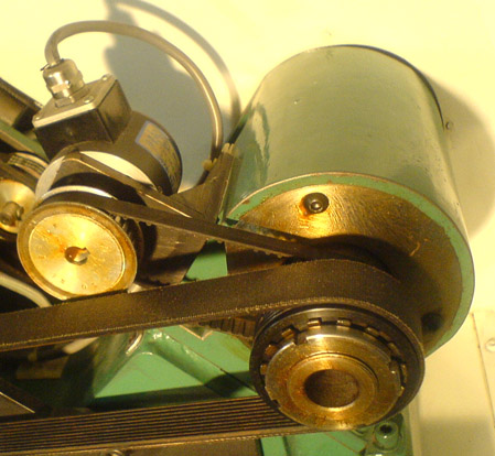

Here's the encoder:
I have an existing mach 3 setup with a Grex g100 driving servos for a benchtop mill and am currently only using 3 of the 6 available axis on the controller. I am considering purchasing some g201's to drive the 2 steppers and loading up a separate config for machturn and that way I won't need another pc, etc... to control the lathe.
Right now I am trying to figure out if it's possible to configure mach3/grex to utilize the homing switches (datum sensors) that are equipped with the mirac, and also if I can use the spindle encoder equipped with the mirac.
I'm planning on using a digispeed xl for the pwm conversion but am not sure how (if possible) to configure mach to take advantage of the encoder for the spindle control. Would save me the hassle of putting together a pulse-type indexing setup.
Thanks again for everything... you guys are a great help!
Here's the encoder:
- spindl_enc.jpg (98.6 KiB) Viewed 20695 times
I'm sure there will be a way to condition the signals for the Gecko or Mach - CNCzone would be the place to get those kinds of answers though.

spindle encoder - indexing
I'm looking into using the z channel on the spindle encoder to signal the one ppr that mach 3 requires for spindle control. Apparently mach 3 doesn't support more than 1 pulse so I won't be to make use of the 60 ppr signals generated by the A/B channels.
So, I'm curious... does anyone know what the LCB3 controller was doing with the A, B and Z channels from the encoder? Or rather, what was the purpose of the indexing (z) channel in this application? How did the LCB3 specifically make use of the encoder's indexing feature?
Thank you Magoo... that's great! I mostly just wanted to know what I was giving up by possibly letting go of the 60ppr channel with the upgrade. My most obvious concern was losing any threading capabilities so this is good news. So the 60ppr must also be used to indicate direction as well then I would assume.
I presume that Mach will still be able to calculate spindle speed from the index pulse - it will just be less accurate.
I'm also guessing that you won't be able to do threading in Mach if you ditched the single pulse and retained the 60ppr signal ?
- unless Mach can keep counting up to 60 and therefore knows when to start the next threading pass ?
I found out that the spindle encoder functions at 5v (input/output) so theoretically it could work w/ mach using the 1 ppr indexing channel. I am told that mach is unable to read more than 1 ppr and so it seems like an ideal match to me. If the 1 ppr indexing channel was originally setup to control threading and mach is designed to utilize 1 ppr for threading control then why shouldn't it work?
Someone at the mach forums mentioned that the 1 ppr signal may be too short for mach to register it through a parallel port. But, I was planning on using the Grex's ethernet port to send the signals back to mach so I wonder if this could make the difference?
