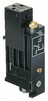

i saw the other switches x ( 2 switch ), y (2 switch ) ,z ( 2 switch 1 up and 1down white limit switch on the Z axis ) , door , toolchange ( 4 switches)
do you have any foto of < the air pressure switch > and where is it on the machine ???
I want to know what looks like
Re: ERROR NUMBER < 5 >
It will be located near the air solenoid blocks ... where all the air pipes start off from.
There will be a black cap with a symbol on it like this:

We think it may look like this
RS Stock No. 723-006
Brand: Crouzet
Mfr Part No. 81513502
Brand: Crouzet
- crouzet-pressure-switch.jpg (13.67 KiB) Viewed 35163 times

If you turn the machine off & then link both wires that go to the air pressure switch together that will bypass the switch.
