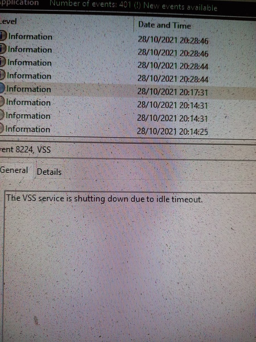

Have you looked in the Windows event logs to see if anything has been logged by the system?
Re: Earth Clamp Mod

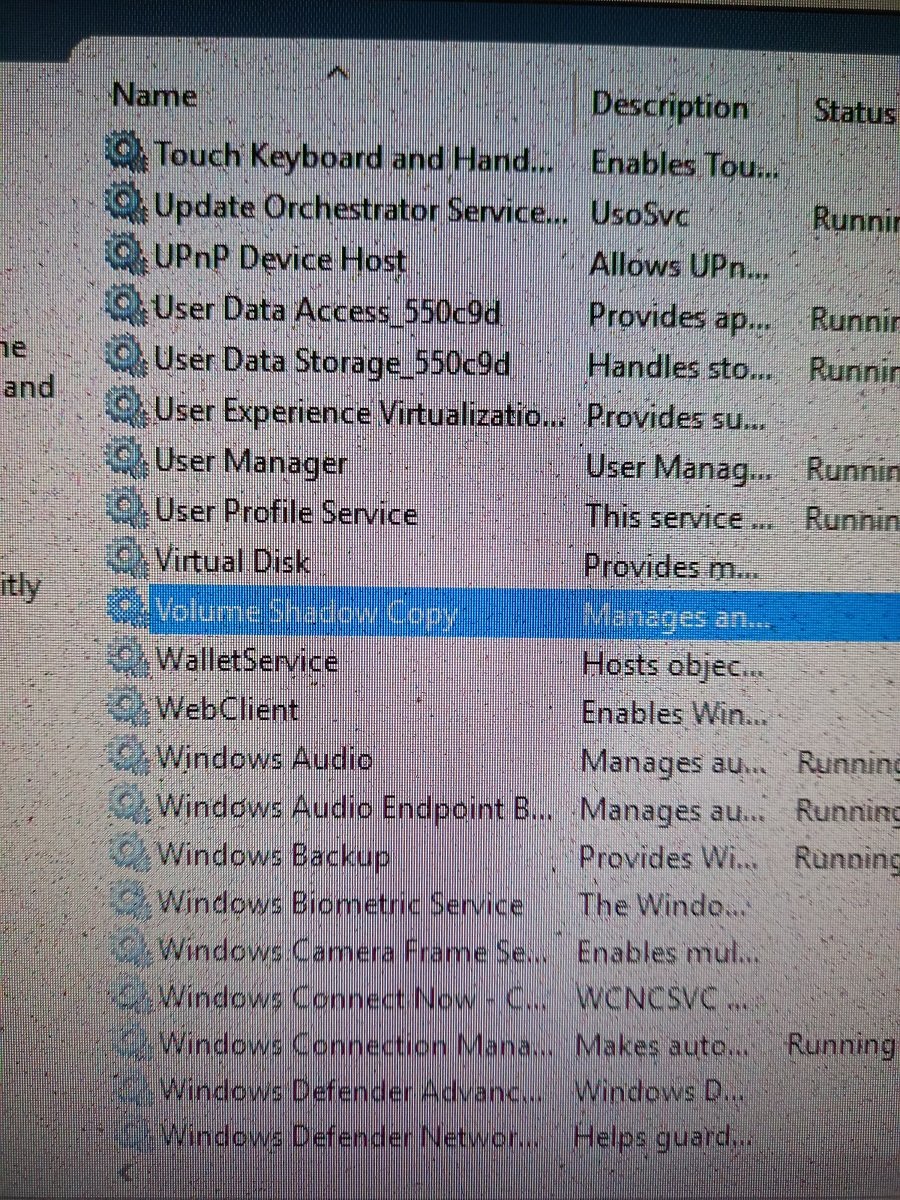

David, I did as you suggested and found "VSS Service is shuttting down due to idle timeout".

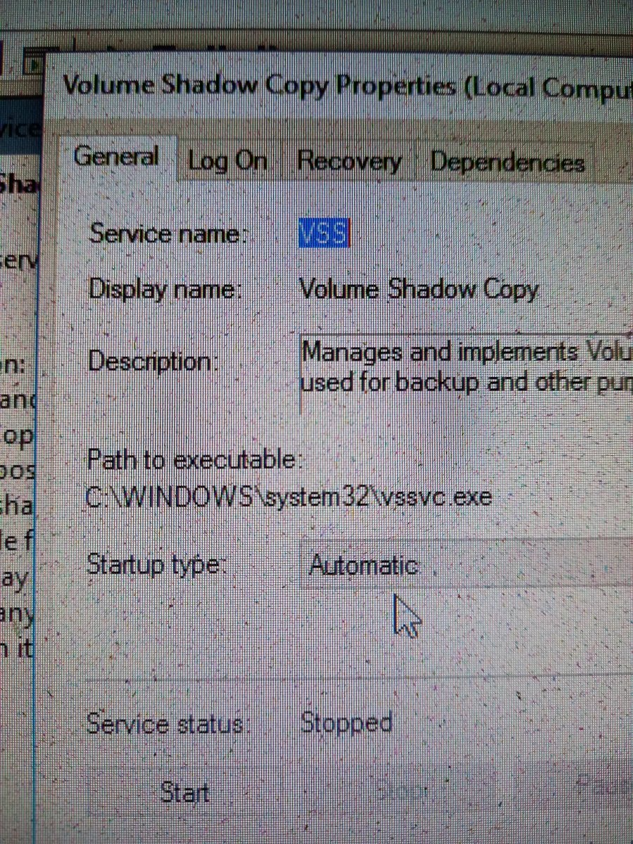

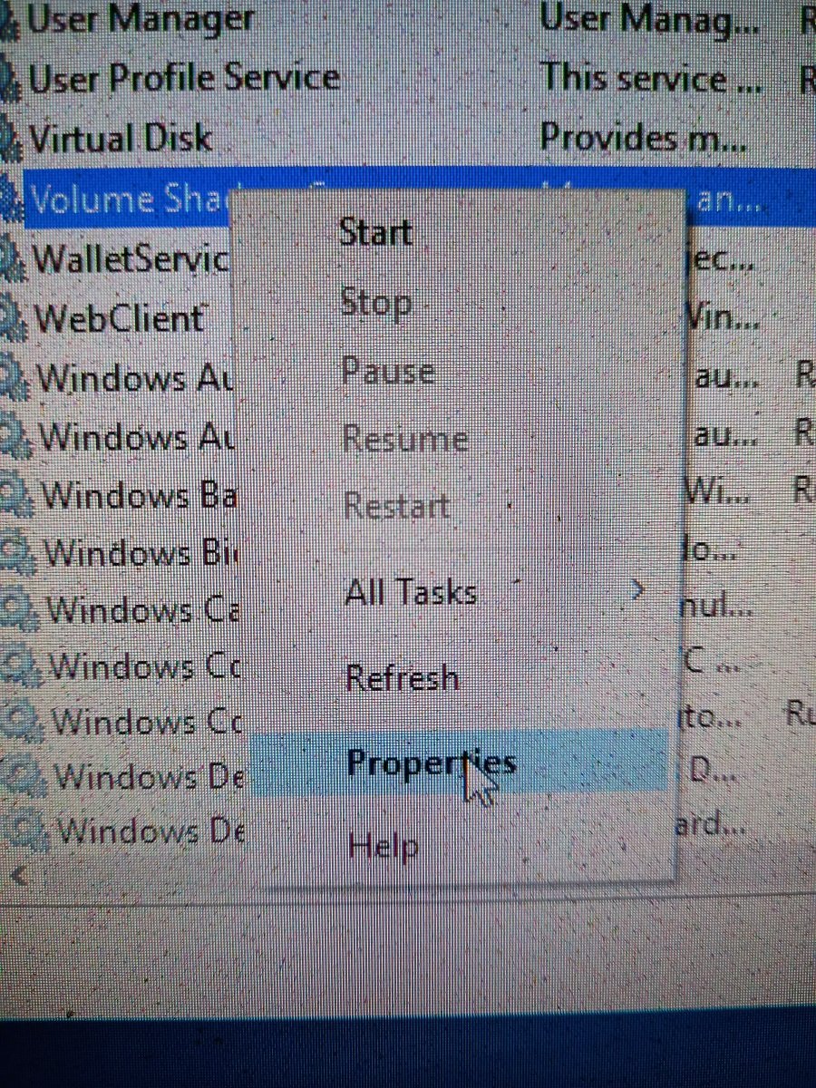

After Googling VSS Service, I found that the "Volumn Shadow Copy" settings were coming up on a lot of CNC boards.
I went to the Services window and found "Volumn Show Copy", hit Properties and set Start-up Type to Automatic from Manual and...
IT WORKED!!! It ran whole whole 140k g-code without missing a beat. I will try it again to make sure it wasn't a fluke but, as of now, problem solved.
Thanks again, David. Brilliant. 8)
