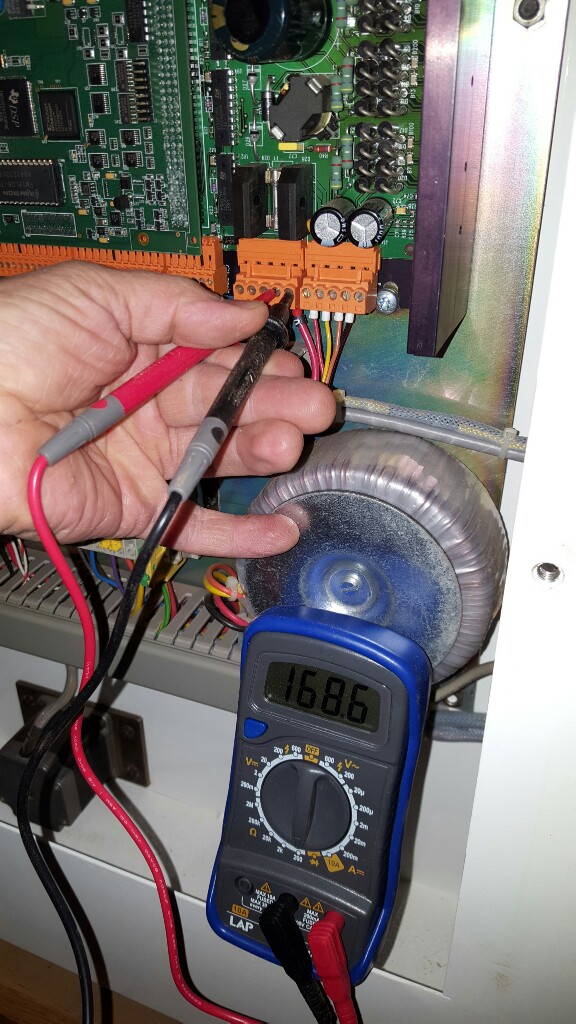

Hi Martin. Thanks for getting back to me so quickly. I have no background in electronics so please bear with me!
I found TB11 and the 24v pins, attached a multimeter and got a resistance reading of 168.6 (see pic)
I have not got a clue if I'm reading it correctly or if it's good or bad. I'm hoping you might walk me through it in baby steps. Many thanks in advance.

Martin asked you to check the voltage on those pins not the resistance. turn the dial on your meter to 200v~.
It isn't wise to connect a meter on the resistance setting to a powered circuit.

Thanks Pete. You're right. I was sure to isolate the machine.
I've rechecked and, with the meter set at 200v~, I get no reading. Zero, zip, Nada, 0.0.
What's my next move? I really hope the board isn't finished. They've stopped making them haven't they?
Thanks again,
