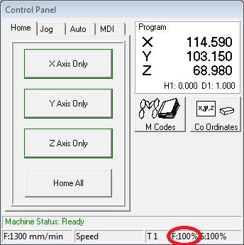

Check that the feed overide button is not on 0%.
