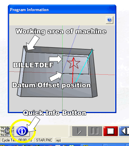

Post by Denford Admin » Thu 05 Oct , 2006 15:34 pm
This isn't the same problem - this is a problem with the positioning of your workpiece and datum setup.
The message is basically saying that the machine is being asked to move past its software limits ie, outside the movement capability of the machine, by the program.
See one of my replies here to help you out:
viewtopic.php?t=48
NB, If you are using VR Milling version 5, then I recommend using the blue quick info button to verify your program and datum offsets are all set correctly - it will warn you of move exceeds limits errors BEFORE you start machining
