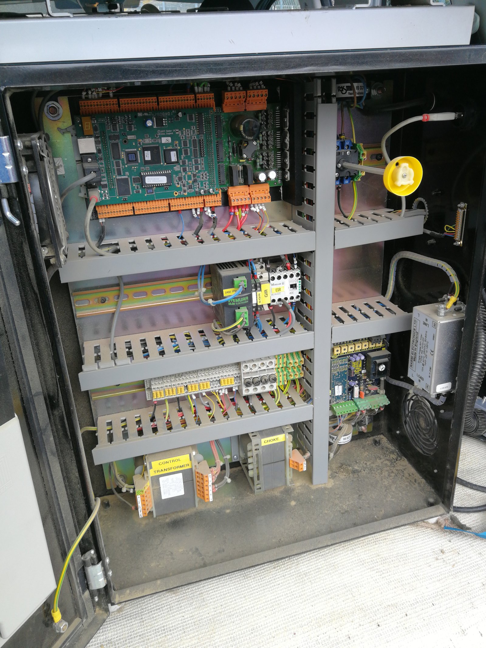

Hi, thanks for the reply. Interesting. Mine is definitely the V3 with separate control cabinet shown below:
I've pulled the wiring diagram from the door and compared and it's definitely a 13-2-2001 style of machine that seems to have been upgraded to a 9-11-2001 that includes "3A steppers", vacuum pump and sprint 1200. It's got the VPR relay but still retains the choke.
I've not got a separate stepper driver, and there isn't one in any of the diagrams - everything is driven from the denstep with the L298 2A steppers.... Perhaps 3A is calculated as 1.5A per phase, two phases = 3A?? Anyone form Denford able to comment? The L298 feedback resistors are still the 0.47R used on every other denstep I've seen.
