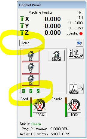

The Homing routine for the machine is that the slide moves towards the home switch until it hits it and opens the contact. Once the contact is open it reverses and moves away slowly until the home switch closes again. It then stops and is at home.
It sounds like there is dust trapped between the contacts of the Z home switch. If you vacuum the switch whilst pressing and releasing it it should clear.
In home mode the status of the datum switch is displayed. If any of the datum switches are operated (the contacts are held open) then the axis is shown highlighted in green.
If the switch has dust holding the contacts apart or you have a faulty switch the axis will be displayed. With the guard open and in home mode if you manually press the home buttons you will see the indicators going on and off.
