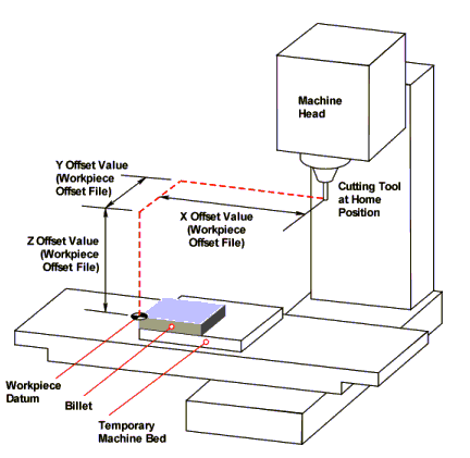

Normally all move values will be postitive - this is normal.
If you look at the above picture, you must set up the workpiece datum by touching the tool on that bottom left corner and zeroing the XYZ work piece offsets.
This corresponds to the bottom left hand corner of of your techsoft design.
Any XY moves inside the job will be positive, eg
Bottom, left corner of billet and design is X0 Y0
Top, right corner of billet and design is X100 Y 80 (mm)
Therefore tool in the centre of the billet would read X50 Y40 (mm)
Also its worth making sure you setup the page in techsoft to match the size of your intended billet / workpiece.
