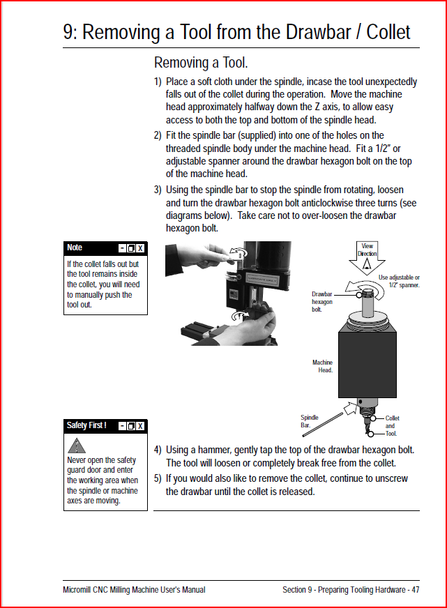

I found the solution to my collet issue.
Re: Micromill 2000(scantech rebrand)
Post by Steve » Tue 13 Aug , 2024 14:06 pm
Hi If you download the latest software for the machine you will find the machine manual on the download that may be helpful.
https://www.denfordata.com/downloads/VR ... _32_CD.zip
