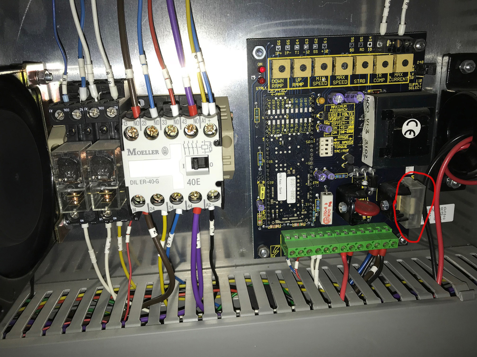

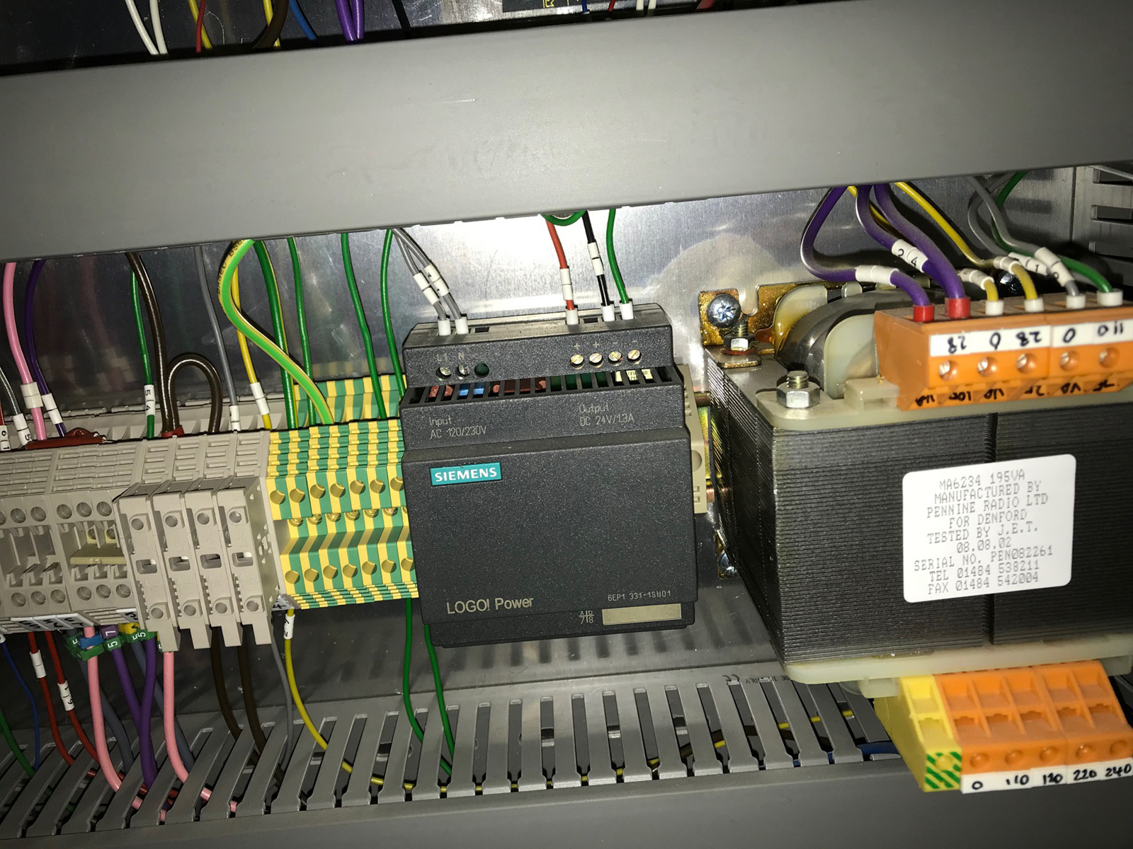

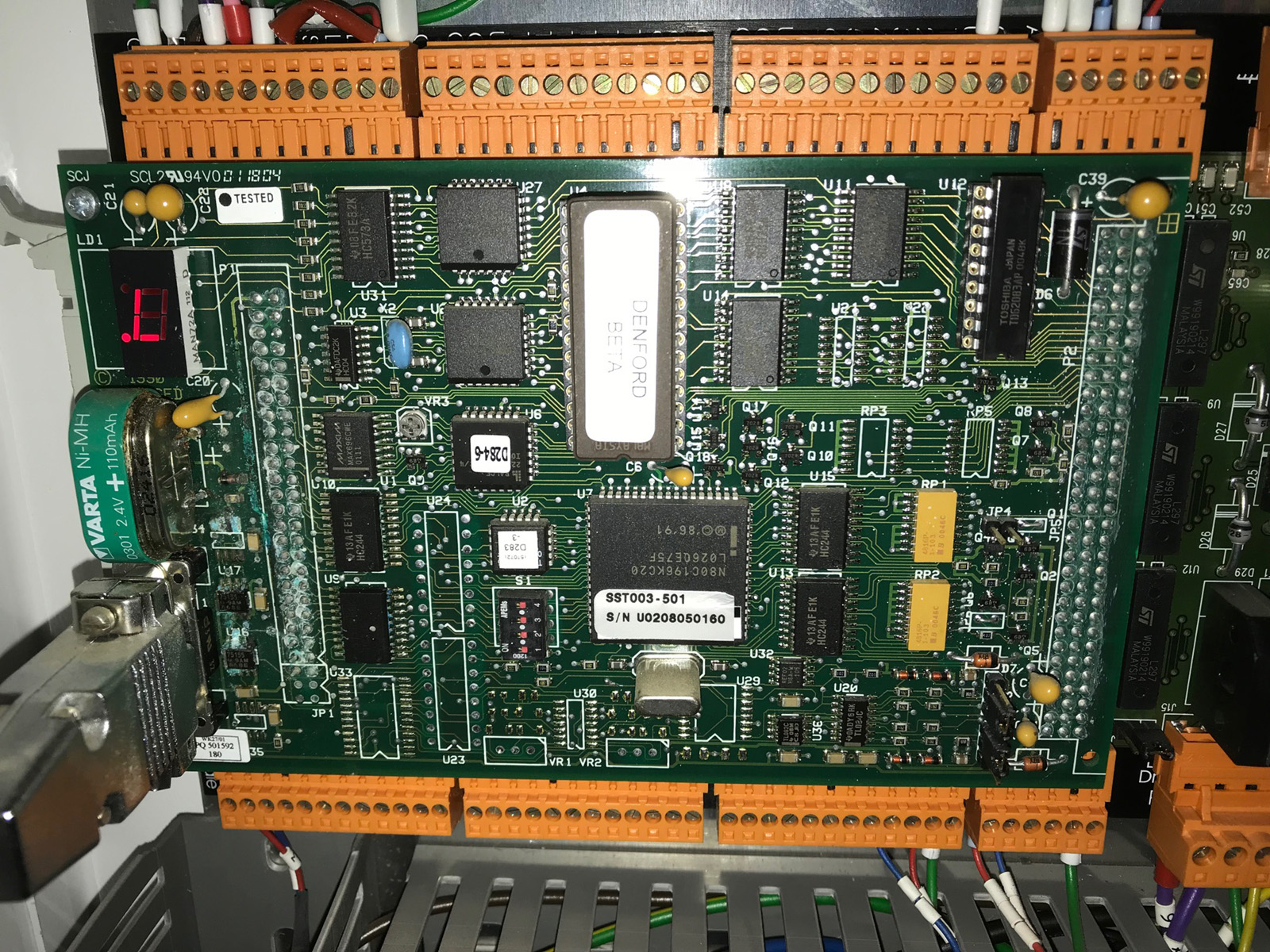

I purchased a Denford Micromill 2000 from a school last year that powered up fine at the time. It has been in storage and I have finally got the time to get it up and running for low volume wooden and acrylic signage.
The issue is it seems to have lost power. When I power the machine up the door unlocks fine but I have no red light on the front but I do hear a click when I turn the key. I have checked the two fuses I can see (one on the main board and the other fuse ringed in one of the photos attached)
If anyone can point me in the right direction (the fuses tested ok with a multimeter) as to what else could be causing this. I will at some point be upgrading the machine but it would be nice to get it up and running in the meantime (I have all the software).

Hi, You say you have lost power, what makes you say this? Power needs to be present for the door interlock, the Denstep board is showing L on the display and the LED is lit on the Spindle controller.
The Power light on the front of the machine could just be the bulb has failed (we had 2 machines from new at work and they failed within a year or so, doesn't stop the machine working)
You look to have corrosion on the board near the battery (some report issues when this happens)

I was looking at the corrosion and was concerned it may effect signals in that area which may include the comms. Likely the battery leaking but they can be replaced. I think the usual process in this case would be to remove all removable connectors in the area and the battery and carefully swab the area with swabs soaked in de-ionised water or distilled water to remove traces of the chemicals causing the corrosion and the corrosion products, as some items are surface mount running some water in that area towards the end of the board may help. Allow to dry slowly like in an airing cupboard, fit a new battery and test. I presume the battery is for non volatile storage back-up but I don't know for what.

Remove the top board and clean up (i have been told you use white vinegar to neutralise battery leaks, need a chemist/scientist to clarify the whole acid/alkaline thing), the battery apparently is not used, the board is quite highly spec'd and has a lot of features not used by Denford.

I cant quite see what the Eprom version is. It needs to be version 2.0. or 2.1 which run the latest VR software.

How do I find out which eprom? Is it on one of the boards somewhere?

Just cleaned the board up with distilled water and its now drying. Once I've let it dry for 24 hours ill give a quick clean with rubbing alcohol too. Regarding the battery, if its redundant on the board can I simply remove it or should I replace it?

As far as I know the battery can be removed.
The Eprom is in the last picture but is not clear. I presume it's a DENFORD 2.0 BETA which is the same as a 2.1 so should be fine.

It does say Denford beta.
