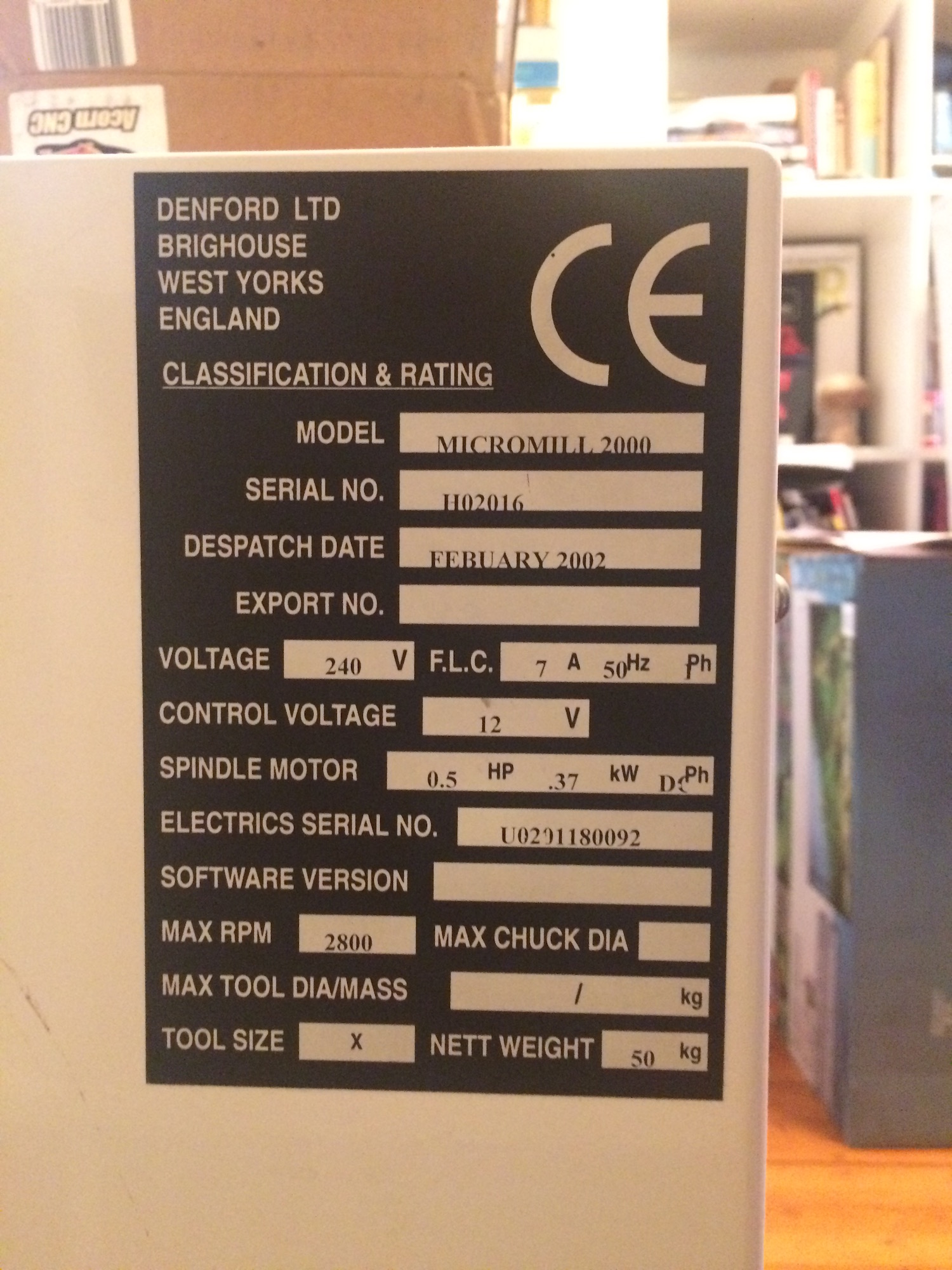

The machine was used in a school to cut mostly acrylics so has had very light use. I'll be using it to make small injection mould tool inserts from aluminium. This is the plate:

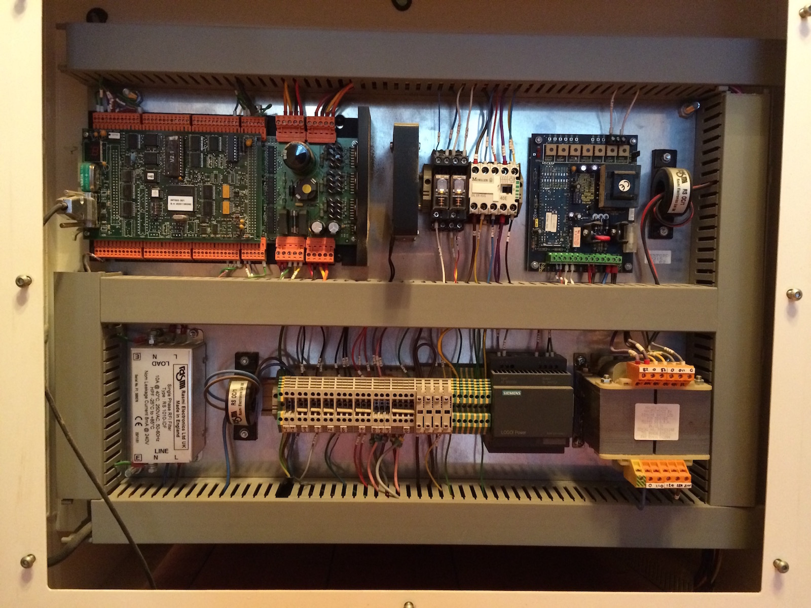

And this is what it looked like before:

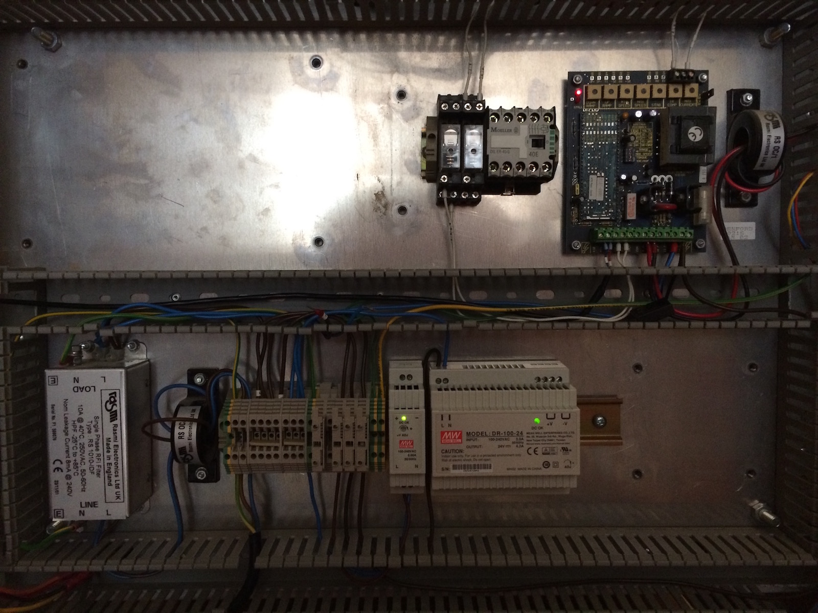

I stripped out the parts I wasn't keeping and changed the transformer to DIN rail mounted power supplies. For now I'll keep the spindle motor control board to get me up and running, but I'll be replacing this and the motor to a faster one later, as soon as I get some advice on what to buy. It now looks like this:
All high voltage wiring is complete and safe (I blew the house fuse on the first test because of a short!) so I'll now work on where and how I'm going to mount the motion controller and stepper controller, and how I connect these to the E-Stop, guard lock, key, fan (new), work light, power light and everything else. The basic wiring is quite logical, but everything listed above is way over my head and I'm hoping I can get some help here.

What are you using for the new control? The original Denford control was quite interesting in the safety features as the software and mechanical linked to make it safe for the eduation environment. It will all depend on what your new control is and just how much you want to 'lock' things down.
If I remember correctly the original set up was,
power on, e-stop out, key switch on, door is able to open.
power on, e-stop out , key off, door locked.
power on, e-stop in, key on/off, door locked.
Power on, e-stop out, key switch on:-
door closed you could rapid move axis and turn spindle on
door open slow and jog move axis, spindle will not turn on.
Spindle running door locked.
There was also a timer on the door lock to ensure all had stopped moving before the door would open.
