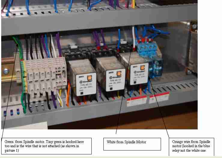

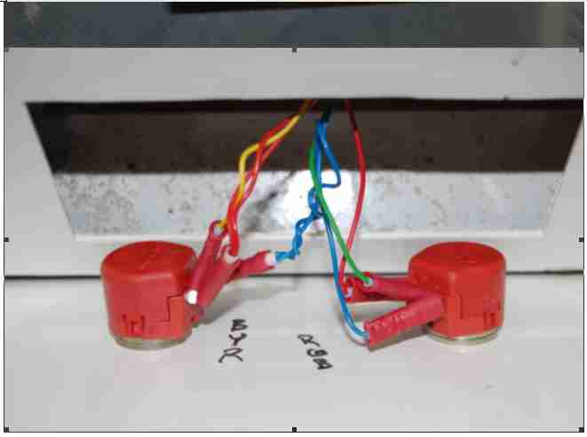

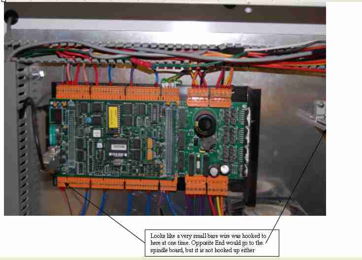

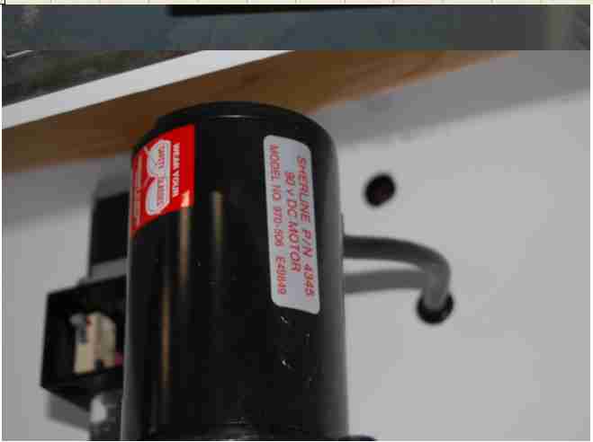

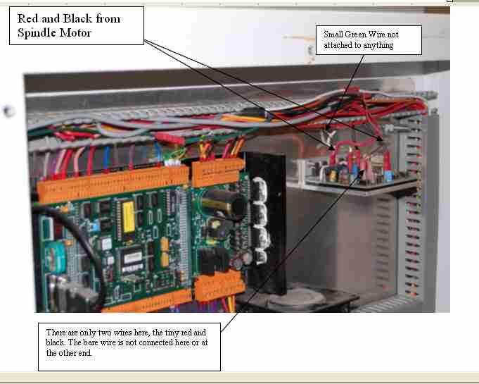

Ok, here are some photos
I did verify that the spindle over ride knob does move the slider on the computer. It doesn't change the spindle speed, but the potentiometer part of it is working.
When using a M03 with any S command, I get what I think is full RPM Spindle reguardless of where the knob is set.
Bare wire not hooked, Green wire dangles (at top)

It sounds like it has been modified at some point.
It may be that the spindle analogue may faulty. The easiest way to check is to measure accross terminals 1 & 2 1672on TB7. It should read 0 to 10 volts DC depending on the speed requested.
Attached is a link to the electrical drawing.Schematic Micromill.pdf
viewtopic.php?f=36&t=2929
Jeff_HATC
Posts: 20
Joined: Tue 27 Sep , 2011 11:47 am
Re: Micro Mill Motor Speed
Post by Jeff_HATC » Tue 25 Oct , 2011 22:06 pm
Based on what you said and the wiring diagram, I found that the wires were hooked to 1 and 3 rather than 1 and 2. Put them on the right terminals and it now works correctly. Thanks for your help
