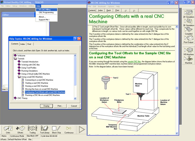

As regards the machine not doing what you want/ expect, I really would spend a few minutes looking at the help file to make sure you are setting up work and tool offsets correctly.
Go to menu Help -> VR CNC Milling
Then select the Tutorials
