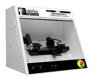

Whats an intelos cnc lathe when it's at home? got a picture?

Post by bradders » Thu 26 Apr , 2007 8:34 am
I think it may be a rebadged Microturn
Interlos Lathe.jpeg (39.05 KiB) Viewed 17706 times
