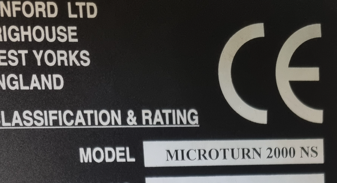

Hi everyone,
Just installed the latest version of VR cnc turning on windows 10 and I get the message Machine mis-match error and suggesting it is a Microturn 2000 instead of the Microturn 2000NS. everything seems to work fine its just annoying every time I start up I get the error. I did try to switch it to micro turn 2000 and it cannot communicate with the machine.
The badge on the machine suggests it is a Microturn 2000NS and the machine I have is usb.
