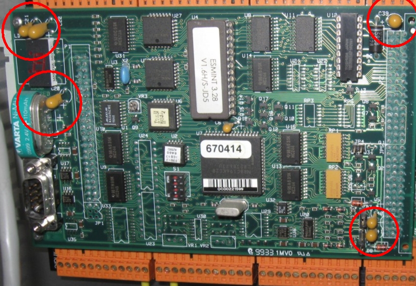

mespe wrote:You man those little surface mount caps? I have no SMT tooling to pull them
Hi mate
I've taken the liberty of copying your picture and ringing the little devils in red. Not surface mount, easy to remove with moderate skills.
They have a polarity and the + side is marked on the board.
If the de couplers go short, they will bring the board voltage down. Sometimes they pop their caps off, sometimes not and can just cause so much interference that the board refuses to start.
I can't remember what values they should be but I will find out, it's not critical anyway.
They are made of a foil wrapper in a paper, they degrade over time and eventually give up or pop.
This will be a custom card made just for Denford so will differ from mine but its age will mean single or dual layer so not a problem soldering in new ones.
