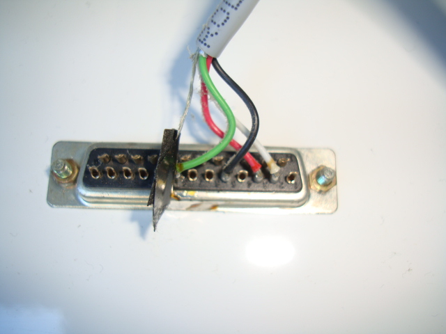

here are the connections mounted on 25 pin d-sub connector on side of cabinet
- DSC05808.JPG (106.02 KiB) Viewed 9295 times
