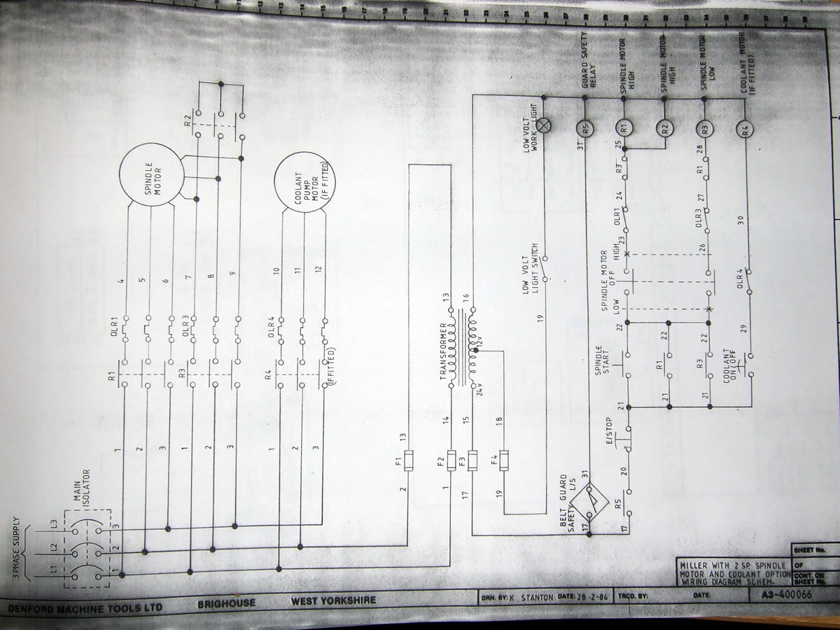

Anybody got a schematic for the Easimill 3, 3 phase version fitted with the 2 speed motor. Have fitted a new 3 phase invertor driven motor to mine and would like to tidy up the wiring.

many thanks for that schematic, unfortunately that is I think the one for the varispeed version. My Easimill 3 is the belt change 2 speed motor version - any hopes of a schematic for that one?
I probably confused things in that my new motor is in fact driven by an invertor which I have fitted.

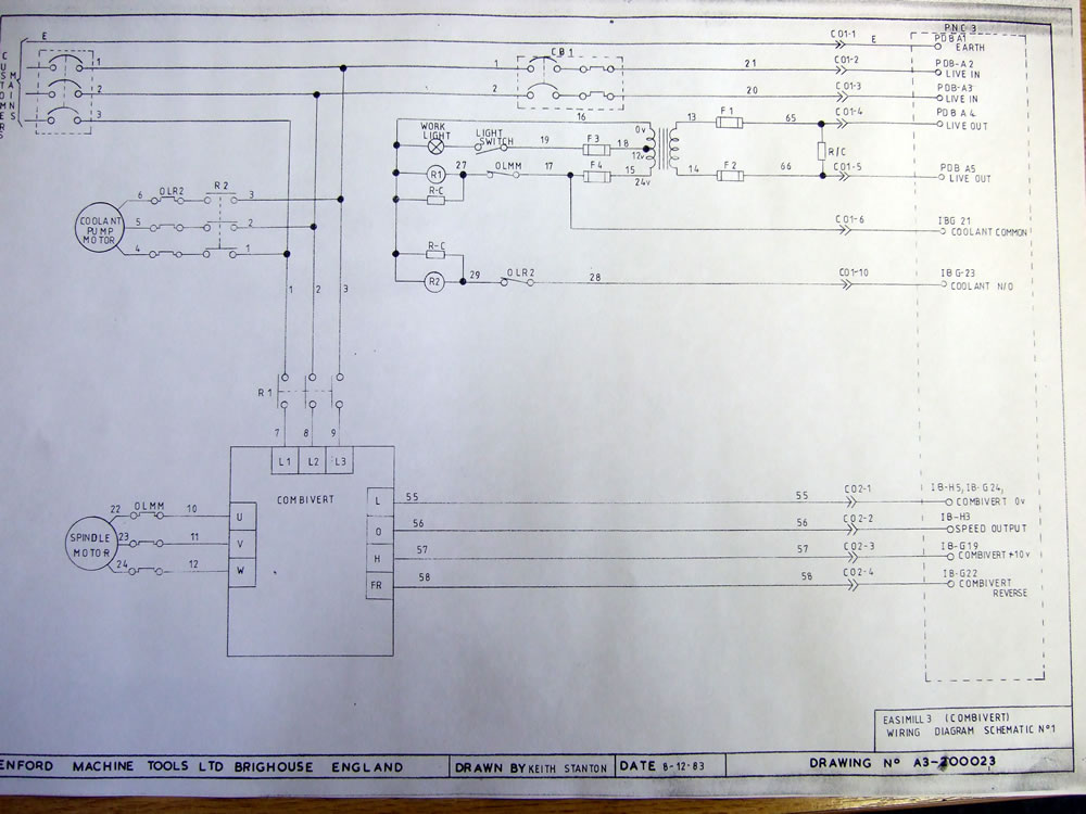

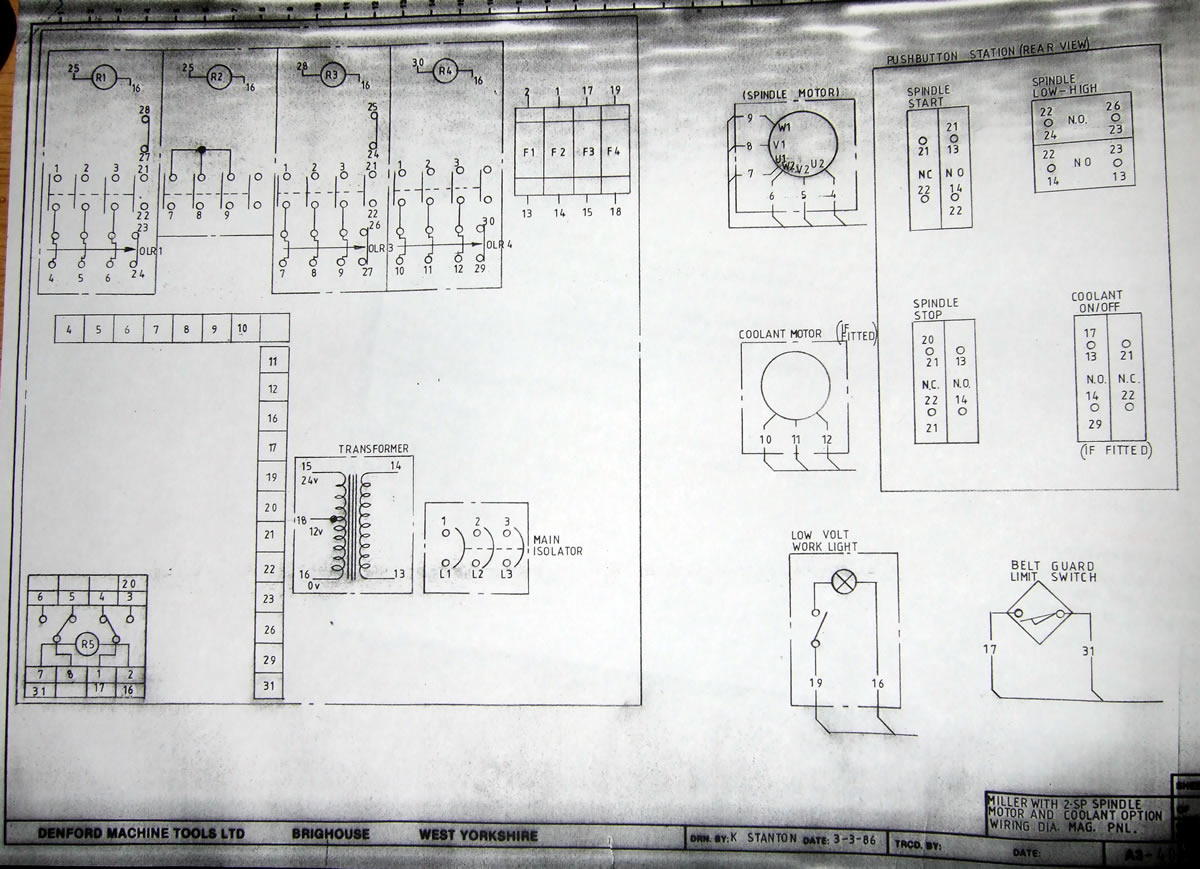

I could only find these - they could be for the Easimill ?
