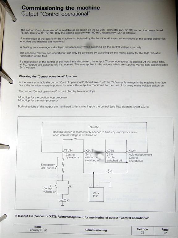

Has anyone got a E Stop circuit diagram for an Easimill with an Heidenhain Control ?
Post by Denford Admin » Tue 06 Mar , 2007 11:52 am

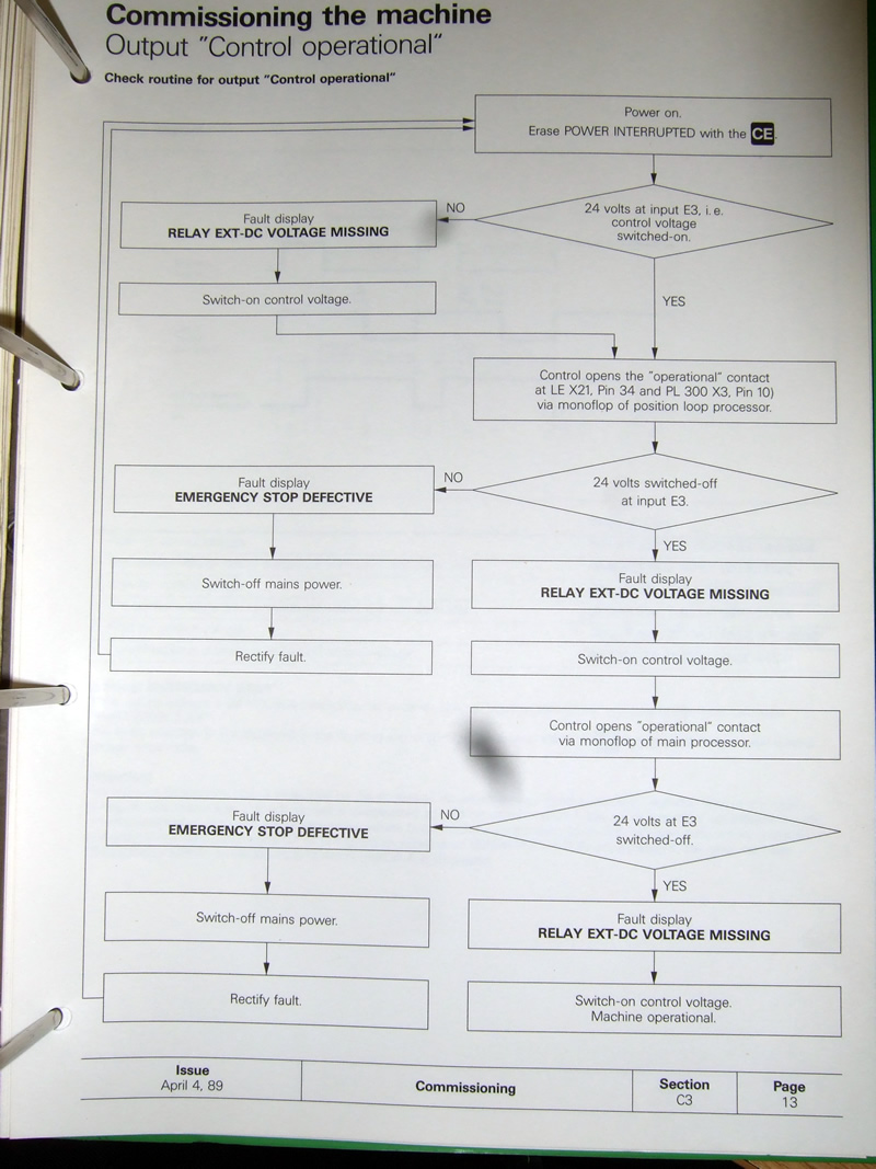

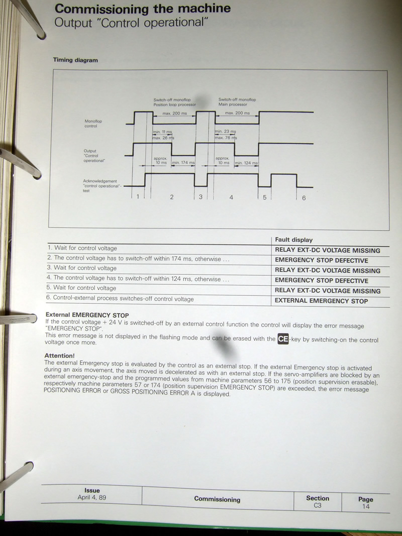

These images are from the Heidenhain TNC 355 commisioning manual.
The flowchart shows what will cause the messages:
Relay ext-dc voltage missing and
Emergency Stop Defective
Output "Control Operational" page 3
Output "Control Operational" page 2
Output "Control Operational" page 1
