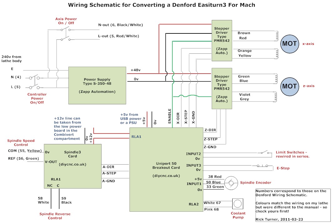

In the hope that it will perhaps make life easier for somebody else, I will attach to this post an electrical schematic, the XML file for Mach (either rename it to 'mach3turn.xml' or use a 'profile' shortcut), as well as a diagram showing the pin-outs on the three cables/plugs that come up from the lathe body to the original electronics unit - all the control cables you need are in these bundles. Note that I've had to upload the XML file in ZIP format as the forum does not allow XML uploads, so you'll have to unpack this first.
I am however not happy with the speed control being provided by the Spindle3 card, which seems to be fairly inaccurate - commanding S200 for example gets me 221 rpm, and the difference between the two is not linear, increasing with rpm. (And to forestall the obvious questions - yes, I have used Mach's autocalibrate, and this is *after* that has been done, and yes, the 'actual' speed is accurate).
So, I have a Digispeed card on order, and when that arrives I'll fit that and see how it goes - I'll append the results to this forum in due course.
Rick
Updated version of the schematic - changed the e-stop symbol to a PTB switch, and modified the Spindle3 card power connection.
mach schematic with spindle3.jpg (118.33 KiB) Viewed 30490 times

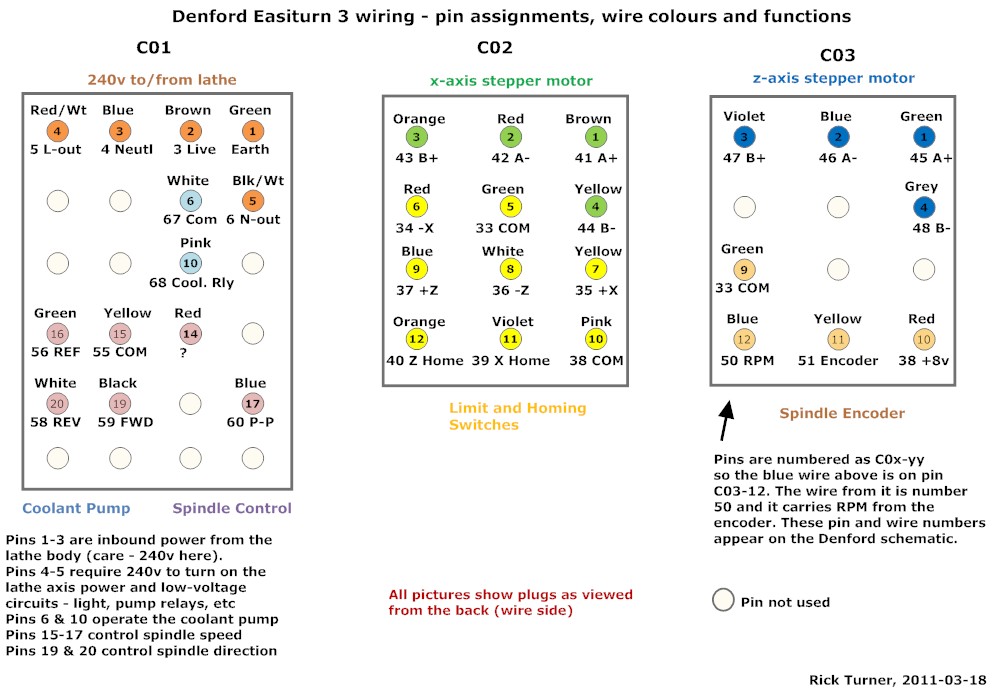

Pinouts for the three armoured cable sets that come out of the lathe body into plugs C01, C02, and C03.
Denford Easiturn pinouts.jpg (135.62 KiB) Viewed 30510 times

Re: Easiturn3 conversion to Mach - some observations
Post by bradders » Tue 22 Mar , 2011 13:02 pm
Rick,
Brilliant Diagrams

Post by rickturner646 » Wed 23 Mar , 2011 21:04 pm
I've just updated the wiring schematic diagramme above to make two important changes:
1) I've changed the symbol for the e-stop to that for a PTB switch, which is what you should have (fails safe in the event of a wire breaking).
2) I've changed the routing of the +12v power line for the Spindle3 card to go through RLA1 on the Uniport breakout card. MAKE SURE THAT YOU DO THIS, IT IS IMPORTANT. Whilst I am tinkering with things I have the Spindle3 card on a separate power supply (just to make my life easier - the card is not installed in the enclosure yet). I normally turn on the enclosure power first, then the spindle card, but for some reason this evening I powered up the Spindle3 card first, and got an interesting surprise when the lathe spindle took off at high speed without being commanded to do so....
Of course, this *should* not happen, but it did, and could lead to a nasty incident. So, to guard against it, I have routed the power supply to the Spindle3 card through the relay on the Uniport controller, which ensures that it cannot get power before the controller is up and running.
Rick
