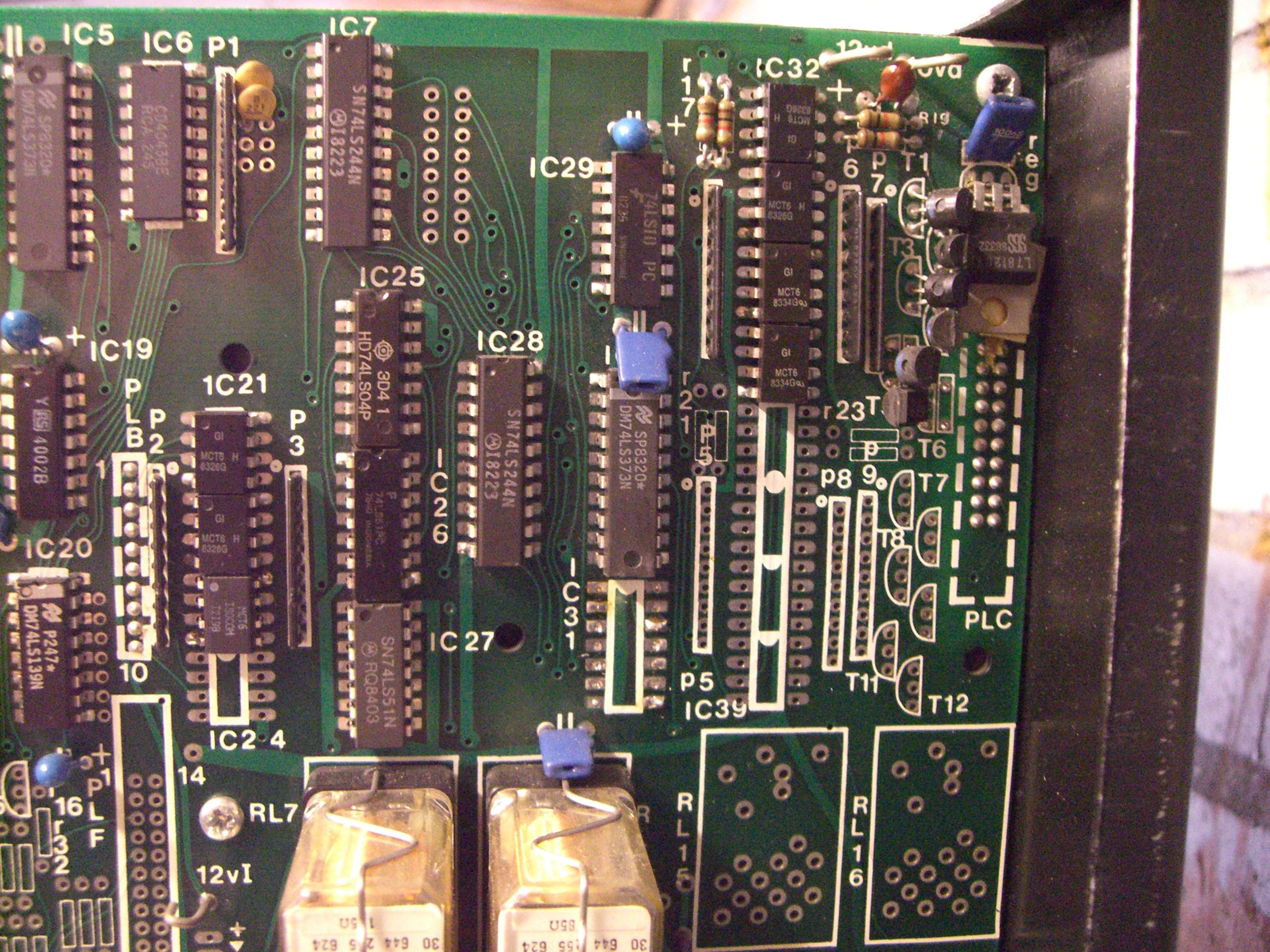

I have no IC39 it empty, see image

Post by Martin » Thu 09 Apr , 2009 15:25 pm
The drawings are the same for the PNC3 Lathe & Mill so I guess we need to be looking at the what the drawings show as the Y Axis on the Electrical Drawings.
Therefore the IC for the Z Step is IC35 & the signal goes out on pin 19 of the ribbon cable.

Post by Martin » Thu 09 Apr , 2009 15:35 pm
Are all the pins ok on connector PLC?. Looking at your picture there looks to be a compound covering the top 4 soldered joints.

Post by Adee » Thu 09 Apr , 2009 22:00 pm
Just checked the stuff you pointed out on the PLC, It was just a bit of the backing stuff from the mosfet above it.
