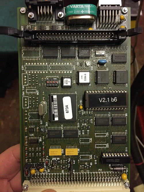

It looks like there is a compatibility issue between QuickTurn 2D Design & the control cards fitted to pre NextStep controlled machines.

Post by malutki69 » Fri 09 Dec , 2016 16:00 pm
angel-tech wrote:i think there are several threading g codes and the software gives the wrong one for the controller. Try editing the g code with the other threading g codes
All I know is my control board supports treading g code G92 and G76.
Can you specify a sample threading program with use the G92 or G76. Regards
