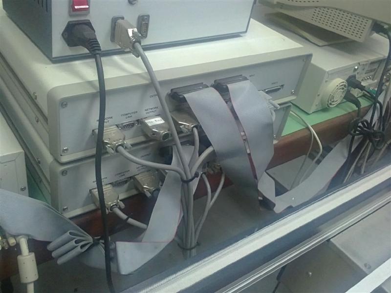

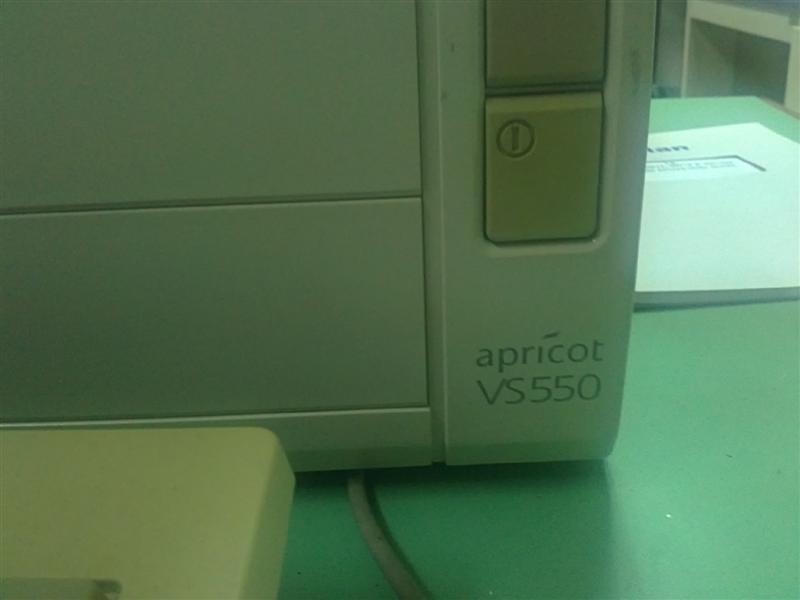

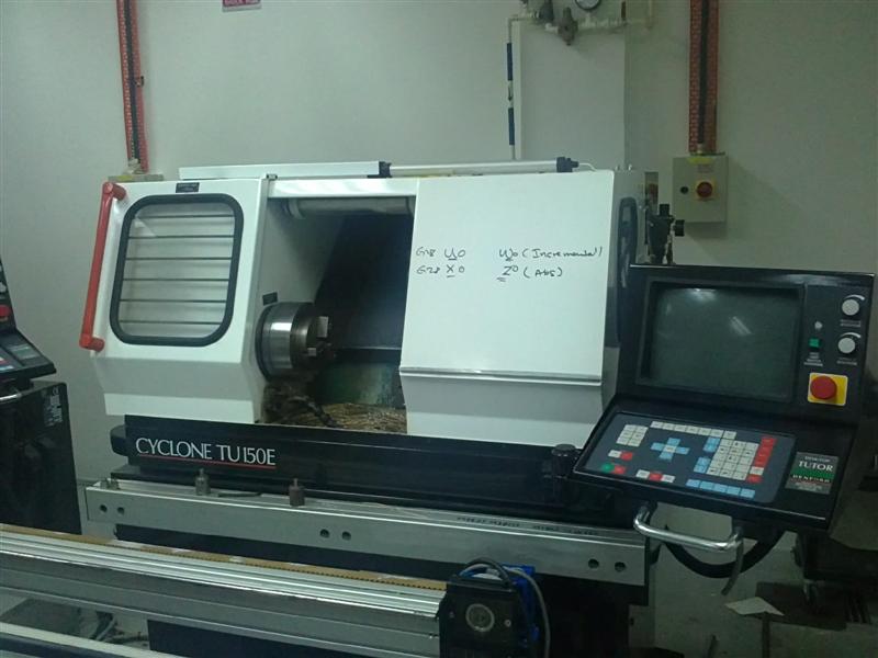

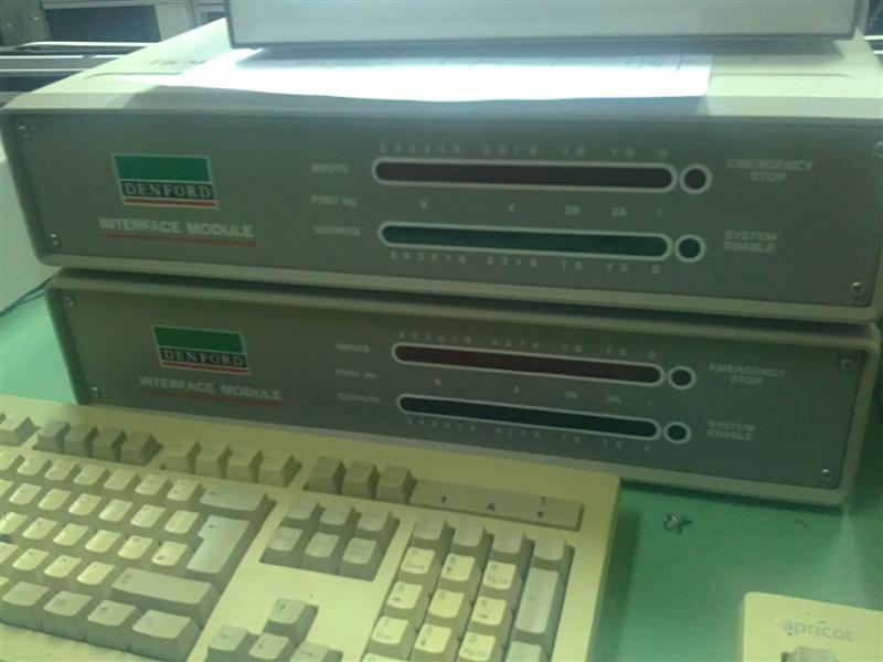

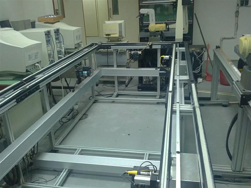

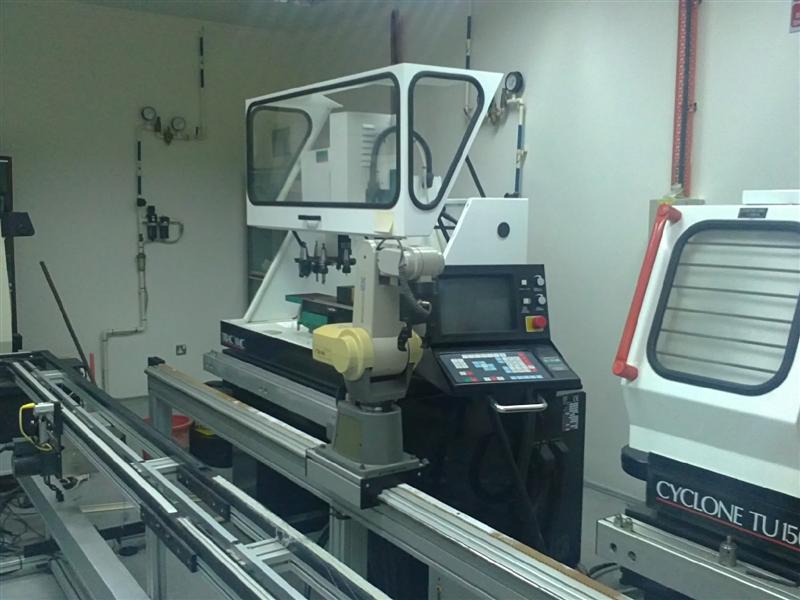

Sorry for the delay. I am to attach our site photo where the equipment located. Please comment.

I think the Cyclone (TU150CY) is serial No EO5034 1997 (Brunei) and had an Optimised Issuer 4 rack control card. In theory this Cyclone will upgrade, but unfortunately we have not had the opportunity to carry out this type of upgrade and check the control software works OK.

This type of cyclone control has never been updated to the latest USB control card so we don't know what problems may be encountered electrically or changes to the logic may be required. Therefore it would involve the machine coming back to Denford UK or one of our engineers to perform the upgrade on site.
Going back to the original problem however, I wonder if you can find a replacement hard disk (eg on ebay) or similar vintage PC from which to run the machine ?

One thing I'm worried about is whether you still want the upgraded Cyclone to work within the CIM or are happy to have it as a standalone lathe ?
Integrating an upgraded machine into the older CIM will be very difficult (if not impossible) as DOS CIM machines work in different ways.
