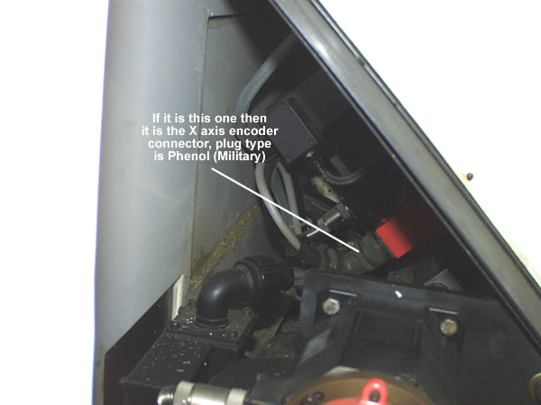

The 416 alarm is an X axis encoder alarm, from the Fanuc OT-B "Bible":-
>>An error in the position detection system of X-axis pulse coder (break alarm)<<
Here are a couple of photos for you, which of these (if any) is the connector you are referring to??
FYI Plugs and cable are available pretty much next day from Radio Spares, https://uk.rs-online.com/web/ if you fancy making your own up.
Rob
Bob
Rob

Re: Cyclone alarm 416
Hi Rob
Thanks for the photos.
My mistake, Z axis, it is the plug in the first or top picture.
Interesting that your plug is angled upwards, as opposed to my one, which points downwards, so the cable drags itself along the bottom of the machine, probably causing the problem I experience. I think I would prefer to just buy a new cable if not an extortionate price, time factor is one, hassle of sourcing and then getting the right cables in the right pins is another.
Bob
Bob
- Lone_Ranger
- Posts: 221
Hi BobEmimec wrote:Hi Rob
Bob
Well, if you are thinking of buying from GE Fanuc the the "E" already stands for Extortionate, good luck!!!
I would check if the socket has come loose and turned round causing that problem, if it was fitted like that then it came from Denford that way!! Ouch!!
Rob

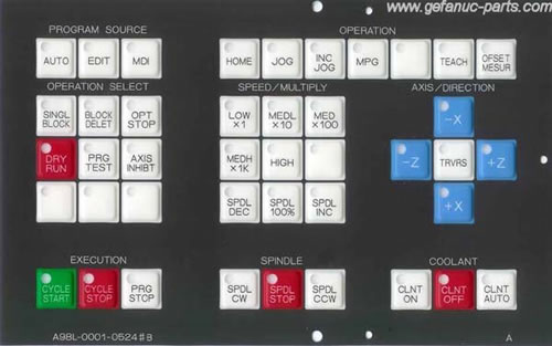

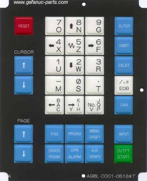

Emimec wrote: PPS. Do I assume new key pad covers are also very expensive ?Some of my buttons have cracked and fallen of, gone brittle with age and lack of use I guess, The most commonly used, clear error, program etc
bob
Very expensive!!
Top keypad Fanuc part number A98L-0001-0518T is €60.00 Euro
Lower Operators Keypad Fanuc part number A98L-0001-0524/B is €89.00 Euro
Shipping "Economy" service is €16.00 Euro
All the above do not include VAT at the current rate in Luxembourg which is where they are shipped from (Not sure but I think it is 17.5%)!!
Dig deep!!!!! Good luck!!
Rob

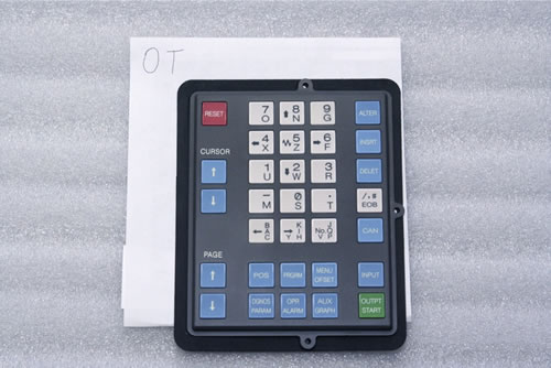

I bought one of these to replace the top keypad, proper buttons, probably never need changing ever as long as not damaged, really nice to use as well!!!!!
I thought it was a bit expensive till I fitted it, worth every penny!!!
https://cgi.ebay.co.uk/Keysheet-Keypad-F ... 911.c0.m14
Rob
Rob
