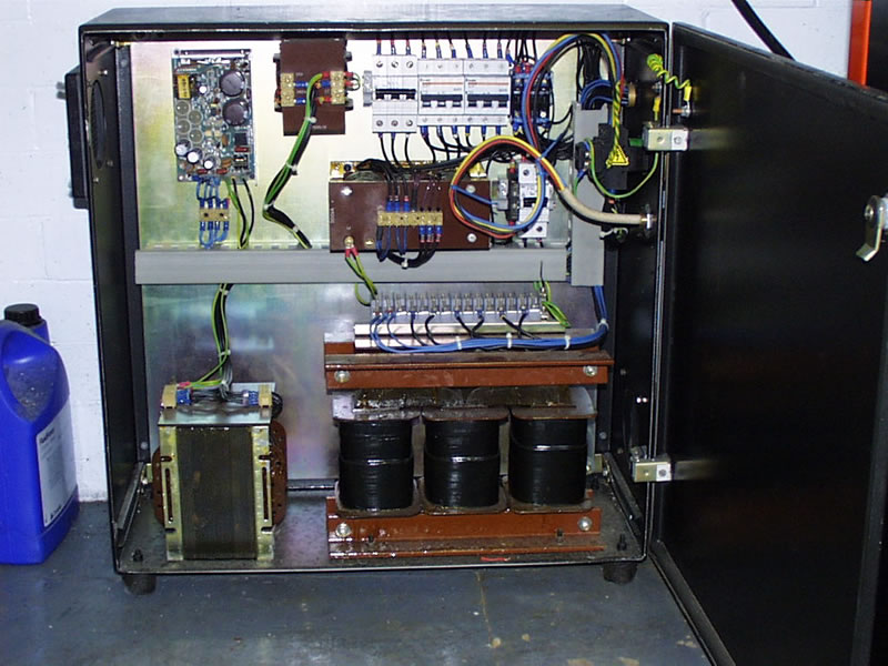

Don't know if anyone out there can give me some advice , have just fitted my new phase converter and powered up my Cyclone and everthing worke fine for around 2 hours then machine seemed to just turn itself off ,have checked all the things that I could think of but nohing , all I can say is that when I press the powere switch on Fanuc unit to turn machine on is that you hear the machine start up but then it turns off , there is power going to all cooling fans and cabinet light and they are all working . I just do not know what else to look for can anyone out there help ???

That kind of behaviour normally indicates a thermal cut-out switch...ie, where things works for a bit, then shut down the power when something gets too hot. Then when it cools, it will all work again (for a while...)

It has had all night to cool down if it was something getting hot , with the main cabinet open when I look inside there is a small red light on and written on a label it says ESR , is that normal ?? also down in main black box when I turn machine on there is a switch / breaker that throws in then throws out almost instantly , not sure what one this is all I can say is that there is a row of switches (grey in colour) and the one that I am talking about is right next to these and is red in colour , you say thermal cut outs is it possible for me to test these ?? if so how would I go about it , do you have any other ideas ??
Lone_Ranger
Posts: 221
Re: Denford cyclone info
Post by Lone_Ranger » Wed 09 Sep , 2009 9:34 am
Do you have anything on the screen at all?? If so are there any error messages??
What exactly does it do, does the screen come on and then go off or not come on at all??
Some specifics of the exact sequence of events (or lack thereof) will help!!
Did you check the output of the Inverter before connecting it and what filter system is fitted to the inverter or in the line to the Cyclone?? It may be that the output of the inverter is too "raw" and has damaged some circuitry, most inverters unless specifically made for use with electronic equipment have a pretty rough output, full of huge peaks, most are just used to drive 3 phase motors that don`t care much how rough the supply is!!!

Post by bradders » Wed 09 Sep , 2009 9:39 am
All the breakers should be on when the machine is running OK, If one is flipping off when you start up there is a problem. Is there any stickers / labels on the breaker, denoting what it is / does, better still post pictures of it and we may be able to tell what part of the electrics it is supplying

Here is a photo of the inside of my Cyclone power supply box, can you tell us which bit is/isn`t working???
One of the things to check in there, in the top left hand corner is the low volt stabilised power supply, check that for output 12V DC. This supplies the control circuits and if that`s not working then nothing works!
Also in the panel on the rear of the machine is a "Black Box" with a Big Yellow lightening flash on it, that is the main Fanuc power supply and it has some Green fuse holders down near the bottom, check those fuses.

Have checked the fuses on the black box with flash on it and have found the 3.2amp fuse is not working !! so I assume that this could be the problem , where can I get a similar fuse from apart from Denford ?? the main box that you have seny me a picture of is nothing like my one I am going to try and attach a picture of my one , If you can see picture in about the middle you can see a bank of grey coloured switches and at the end of those to the right hand side there is a breaker switch coloured red that is the one that throws in when machine is turned on and then out within a couple of seconds , one last thing is there a temporary way of replacing the fuse that has gone to see if that is my problem ??

Can you identify which fuse has blown? Is it one of the grey ones to the right of the Red Contactor? What are the wire numbers that go to the fuse?
I think the Fanuc controls have a power input unit. As you connect the power the contactor pulls in and provided the voltages check out the contactor stays in.
While I have no experiance on the cyclone I have worked on the Fanuc OT controls. You will have a 24V DC supply that feeds all the guard and limit switches for inputs and outputs.
If one of these inputs shorts out (or a cable gets trapped) the 24V fuse could blow and then prevent the unit turning on,
What was the machine doing when it tripped out? Had you operated any switches, coolant pump, guard, limits etc etc prior to it shutting down?

The fuse that has blown is not in the main box in the picture but in the upper cabinet , the box it comes from is the power supply box that supplies the Fanuc unit and the fuse is 3.2 amps

The "Black Box" is the Fanuc power unit and as far as I know you will need to go to GE Fanuc for those, here is a link to the GE Fanuc online shop https://www.gefanuc-europe.com/
Item is only €4.75 Euro plus whatever postage they stick you for!! The part number for the Fuse is A60L-0001-0046/3.2
The Black and Red unit you refer to is the MDC Contactor so if that doesn`t go in and hold in then no power distribution around the machine!!
I think you need someone from Denford to jump in here with the correct schematics for your machine as it appears to be a lot different to mine.
