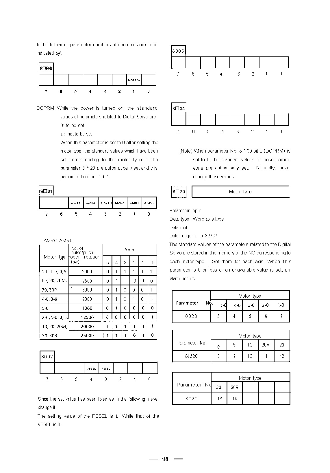

8000 parameters are for the servo motors, you put the correct type in one parameter, reset a bit and all the rest get filled in "magically"
eg set 8020 to say, 9 for the X axis if you had a type 5 motor
set 8120 to 9 for the Z axis
then I think you just have to set 8000 and 8100 to 0 in order for DGPRM to see that you want the other parameters filling in.
you may also have to set 8001(X) and 8101(Z) to determine the ppr(encoder pulses) of the servo motors

Dear Sir one more question before i try to punch in something.
My motor type written is A06B.
And the 8 thousand parameters are starting from 8100 to 8279.
Where are these 8020 and other 80-- ?
Secondly when i try to enter the 900 parameters some of them even after entering doesnt change?

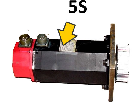

Ok it must be 81xx for the X axis motor parameters and 82xx for the Z motor
ie, insert 1 after the 8 for the 1st axis etc... I thought it was 0 for X and 1 for Z
There will be a motor model type written on it...see picture
About the 900 parameters - maybe some won't change until others have been set

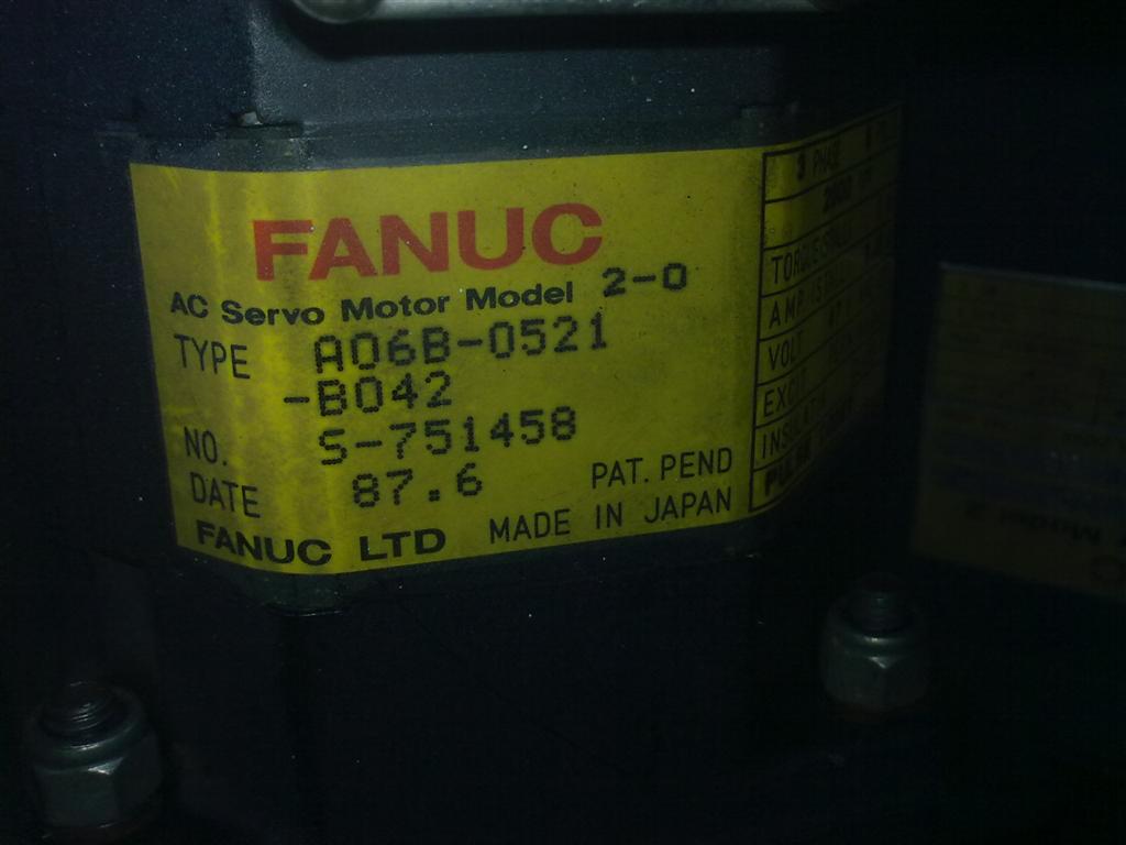

Mr Admin plz hava look at the picture of the motor attached. The type seems to be 2-0.
I have tried to resize the phoograph. Plz accept my apologies if it still appears to be big.

Yes - model 2-0 which is 6 in parameter 8120 according to the table above
