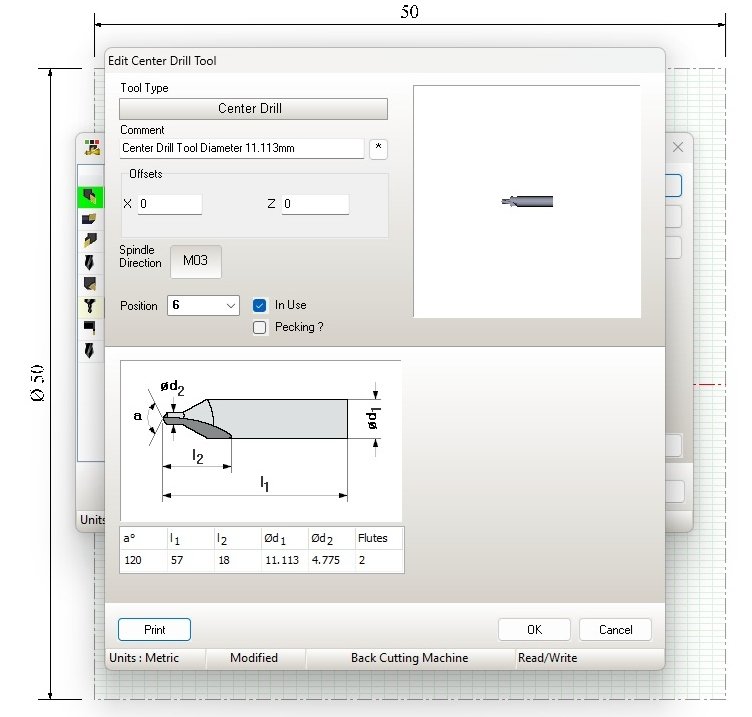

Thanks for the explanation.
The problem is down to my defining a centre drill as having a major diameter of 7/16", 0.4375" or 11.113mm.
This looks perfectly legitimate to me. QT2DD seems to be working on the major diameter rather than the minor diameter, hence the error.
MAX
Mirac Tooling.jpg (62.02 KiB) Viewed 5711 times
Re: Internal machining. Error messages.
I managed to get rid of the drilling errors by fitting a 6mm centre drill in place of the 11.1mm diameter one fitted and editing the tooling file accordingly. I believe Miracs came with 5mm centre drills? I had use a 6mm one as the only spare DB25 holders I have for use with my ATC have 6mm bores.
